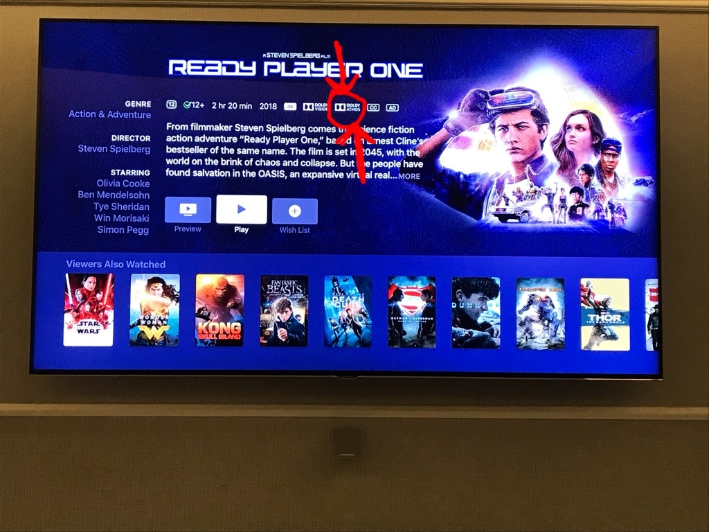

I wouldn't say Apple is crippling anything, keep in mind its a streaming box. Atmos sources are coming from an already lossy DD+ stream. I don't have the beta nor does it seem "ready" by most accounts however you'll find on Dolby's page.....
If the stream is transcoded (not sure how that is possible however DD differs quite a bit from DD+ in the way audio is handled) I would imagine we would need to ditch ARC. However DD+ over ARC is possible with a TV that supports it.
Currently Netflix doesn't support Atmos for the AppleTV so its not an option if you go looking. I believe Atmos in iTunes is like HDR, if you don't have the hardware you can't see the option. This is an image from someone with Atmos on tvOS Beta 12.
