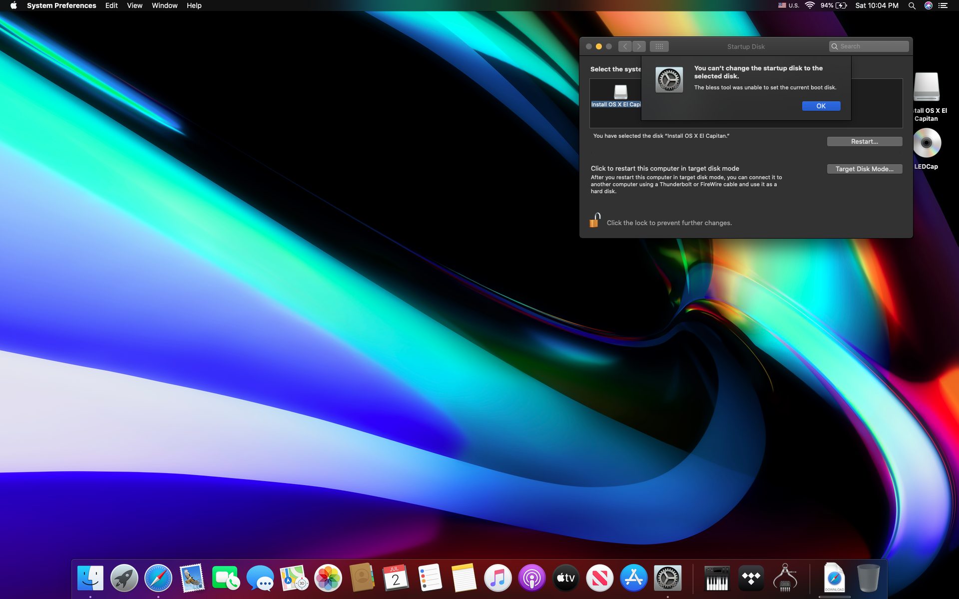

mine will not "bless" the bootable usb drive or show up at all when I do hold option. I'm on a mid 2009 5,2 17 inch MacBook Pro I used apples guide to make a bootable usb.

Dat wrote:
"mine will not "bless" the bootable usb drive or show up at all when I do hold option. I'm on a mid 2009 5,2 17 inch MacBook Pro I used apples guide to make a bootable usb."
I'd suggest you try one (or BOTH) of the following FREE utilities:
- DiskMaker X
- Install Disk Creator
They are designed to make it easy to create a bootable USB installer with a few clicks of the mouse.
IMPORTANT:
If you're not having good luck with one of them,
TRY THE OTHER ONE, as well.
It may work when the first attempt didn't.
