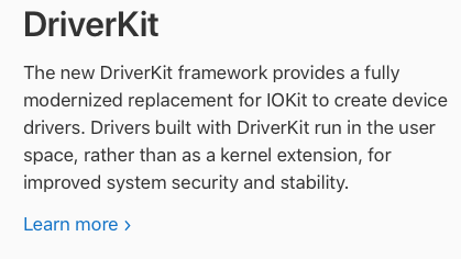

It seems to be a replacement for IOKit. Probably not capable of building GPU drivers. Even the DriverKit link stresses IO operations. Ah well.
https://developer.apple.com/macos/

Driverkit so far is only available for USB and Network. Apple have to implement some kernel abstraction layer, which I believe will take years to be fully implemented to allow for display drivers. Display drivers surely is a low priority to move into Driverkit as very few developers outside Apple, Intel, AMD and Nvidia will have a need to write drivers to support Macs. There are benefits to have display driver in userland, especially when using egpu, so I am sure that at one point Apple will extend also those. Windows have most part of their display drivers running in userland.
