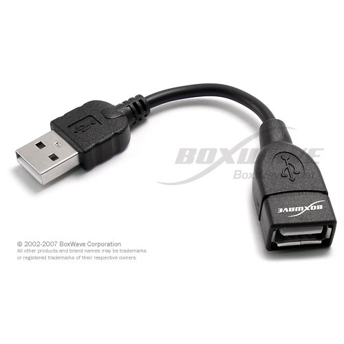

Workaround for Iphone charging port issues
While investigating this USB stuff, I ran across a number of reports of Iphones being picky about charging from non-Apple USB charging ports. (Dell's "PowerShare" charging port on new Latitudes in particular.)
One of the posts mentioned that there's a dongle that fools the Iphone into thinking that it's plugged into an Apple - no matter what USB charger you use.
(click to enlarge)
Here's the link in case this would be useful to anyone:
http://www.boxwave.com/products/iphonechargingadapter/iphone-charging-adapter-apple-iphone_2661.htm
