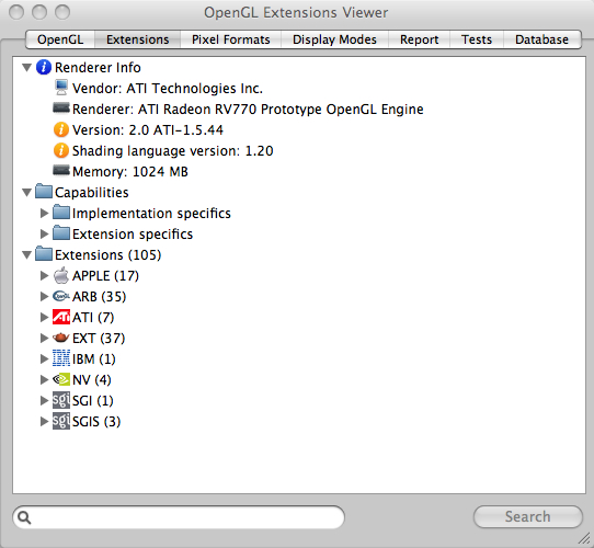

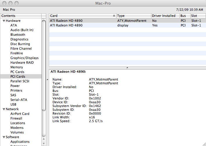

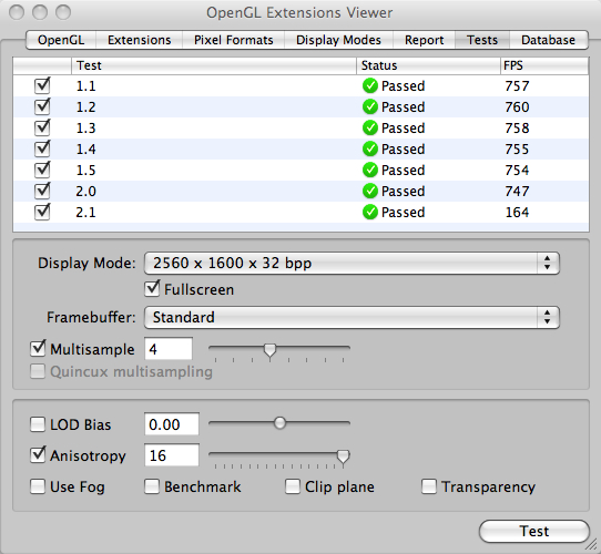

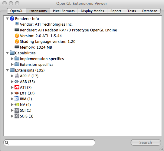

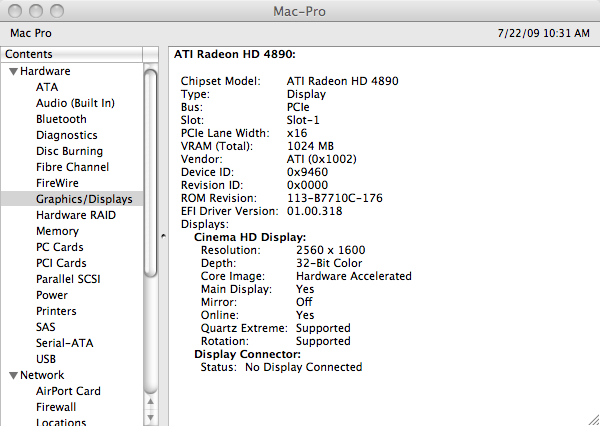

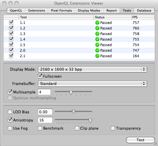

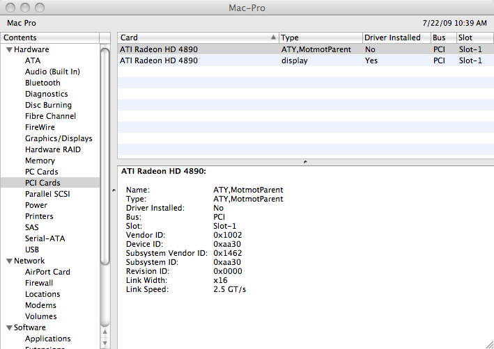

Netkas 4890 ROM working !!!
With ATY_init out of extensions folder...and it still works !!!
Netkas is indeed King for today.
There are a couplde moments in grey boot screen areas where the screen "breaks" for just a second, as if vertical sync off, but other than that it seems perfect.
I was able to hold "option" and pick a bot disk...a new thing for 4890 in Mac Pro.
Mine is an MSI 4890 1 Gig
Most of questions are answered in screen shots.
Will try WIndows shortly but it should be fine.
Now to drag the 2407 in here and do a 2nd monitor test.
If it does second monitor, the XFX 4870 will lose out as "top" ATI card.
Mine is Quad 3.0 from first Gen...so link speed will be 2.5 til it dies.

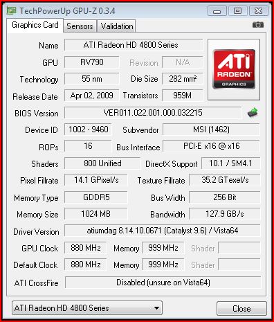

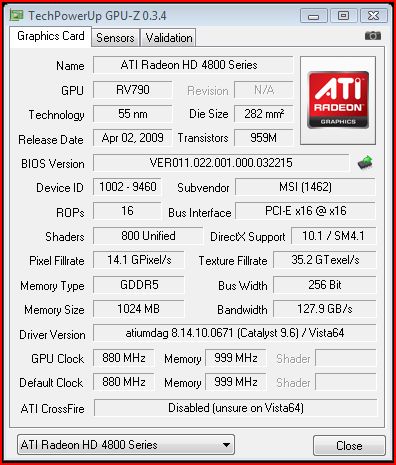

Works fine into Windows
In any case...runs beautifully in either OS once drivers are loaded.
It states "Crossfire Disabled (Unsure in Vista64" in GPU-Z but I'm in Vista64 so hardly surprising.
If anyone is losing sleep over it I can try Crossfire but I have every reason to believe it will work 100%.

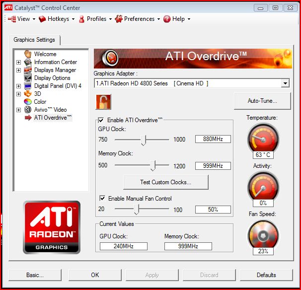

Screen glitches in grey at first grey screen, and then into the Grey Apple screen. Perhaps getting clocks from EFI ROM and they are slightly "off" what it loads from BIOS with drivers?

thats normal attitude for gpu-z in vista64,
means crossfire is not enabled atm (since u have only one 4890)
