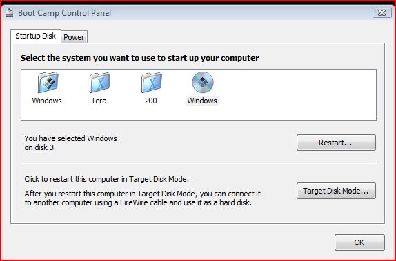

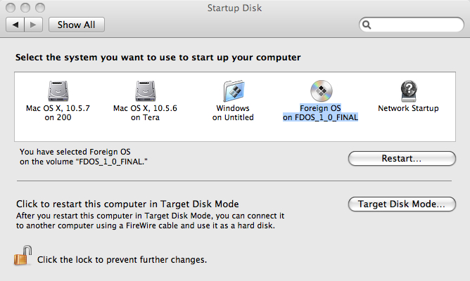

2. Since I already put in the 4890, when I restart to boot from the made boot disk for flashing, I won't see anything. Should I select it in startup disks in Windows? And if for some reason it doesn't work, can I remove the disk and it'll default to an OS? Or will I forever get a black screen?
Note: I can't put both cards in as the instructions ask. They both require power, unlike the suggested 7300GT he had.
You are not renaming the file to .rom as requested. You are not changing the file ending. You need to enable this in Windows settings.
That's the part of those jacobsoft instructions that sucks.
THERE IS NO NEED FOR 2 CARDS IN WHEN YOU FLASH !!!
All you are doing is increasing odds that you will bugger something up.
Get everything ready and then choose your DOS/WIndows disk as startup disc.
Replace your current card with the one you want to flash.
SO MUCH SIMPLER.

I was wondering if there is a way to boot DOS from a HD or USB in EFI? Using optical drives is much more inconvenient.

Where do I change the settings in Windows Vista to show all extensions?
Also, I change the extension within MagicISO (from .bin to .rom) would that work?
