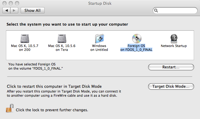

1. While running X1900 chose FreeDOS or Windows as startup disk in "Startup DIsk"
2. Replace X1900 with the 4870/4890, hook up both power cables
3. Restart Mac...it should boot into Windows/DOS as you pre-chose. SAVE YOUR ORIGINAL ROM !!!! Run the flash program and reboot to EFI glory !!!
Rominator, that is correct. My card is a Sapphire model. Standard one, not the Vapor-X I had earlier this week!
I pulled the 8800GT since I needed the power and DVD-drive.
I had a seperate PSU hooked up but it was messy with everything laying around ;-)
So, I put in the 4890 on its own, put in the CD-ROM and kept pressing c to boot it while powering on the MP. After a while I got the boot screen. Easy.
I forgot about the "holding c" option.
I just choose the FreeDOS CD or Windows from Startup Disk Preference pane...takes the guesswork out.
Easier deal with 7300/8800 as those are "invisible" to ATIFlash and won't confuse things as an ATI card running will.
Once you choose FreeDOS CD in this window, close the window without hitting "Restart"
Then shutdown as normal and switch cards at your leisure.
Next time you hit the "Power" button (with a lone 4870/90 in) the machine will boot into DOS. ROMs you save and flash will be accessing correct card as there is no card to FuBar.

Using the Startup Disk thingy is easier indeed.
I was working in Windows to build the CD and stuff so didn't boot Mac OS anymore.
