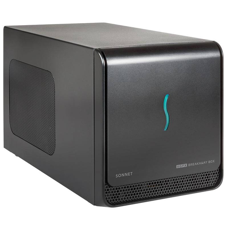

Hi,
I just upgraded to Sequoia 15.4
Now my eGPU freezes and turns off, after pressing the power button. It was working perfectly fine with 15.3.2
Any suggestions?

It’s a mini tower. Sonnet egfx Breakway Box

Now my Treebleet and RX 580 are not working. I haven't upgraded yet. Did you figure anything out, OP?
Can you see your eGPU in system settings? I still can, even though my RX 580 is not working.
Sounds like it's the big box one that stops working
I have the 550W one with an AMD Vega card in it. To be clear, I haven't tried 15.4 (or Sequoia at all) yet so am grateful to get forewarning from this thread.

Actually, I think my issue was a loose thunderbolt cable. I'm still on 15.3.2! And I'm still scared to updated to 15.4 . . .
