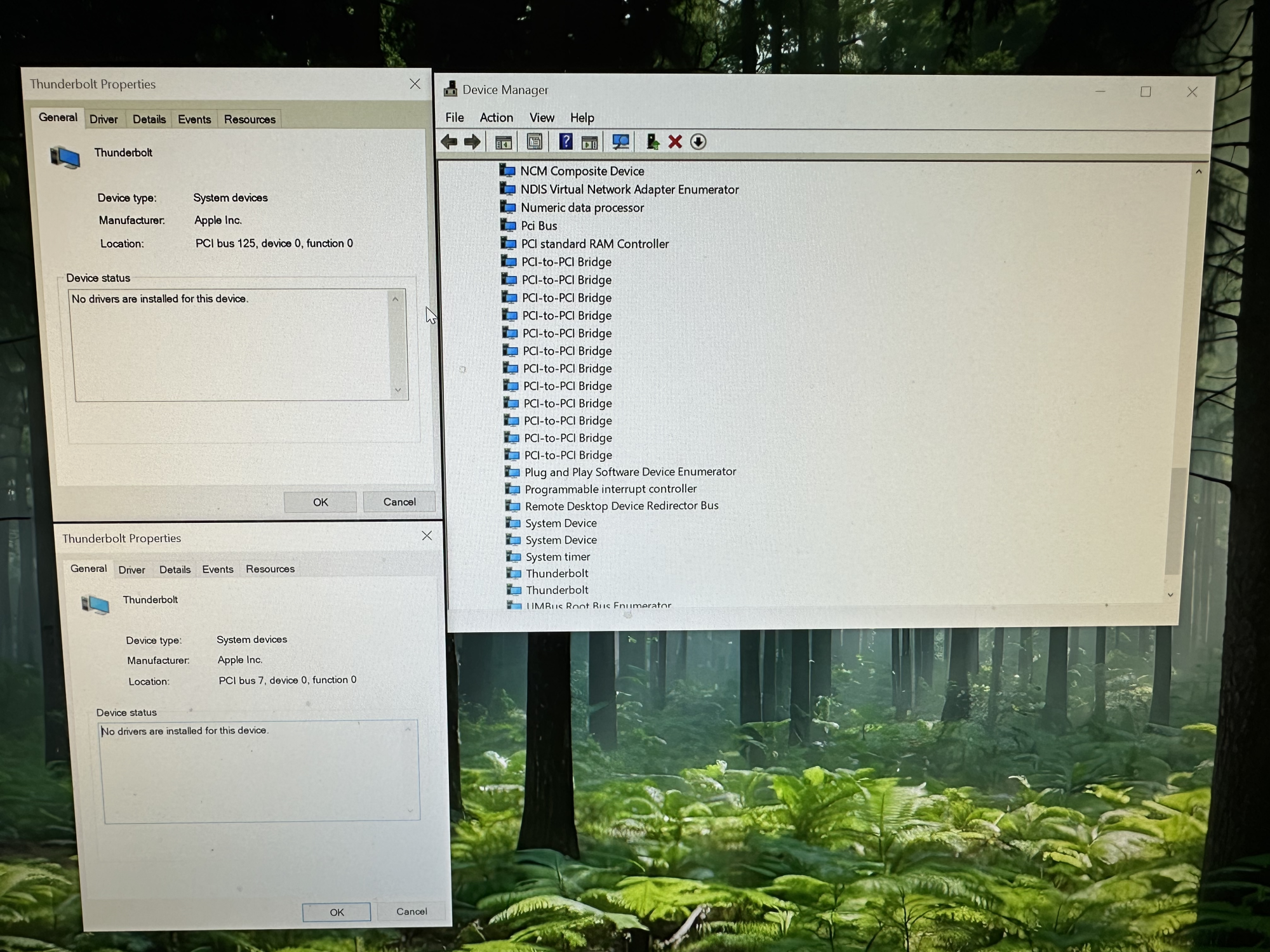

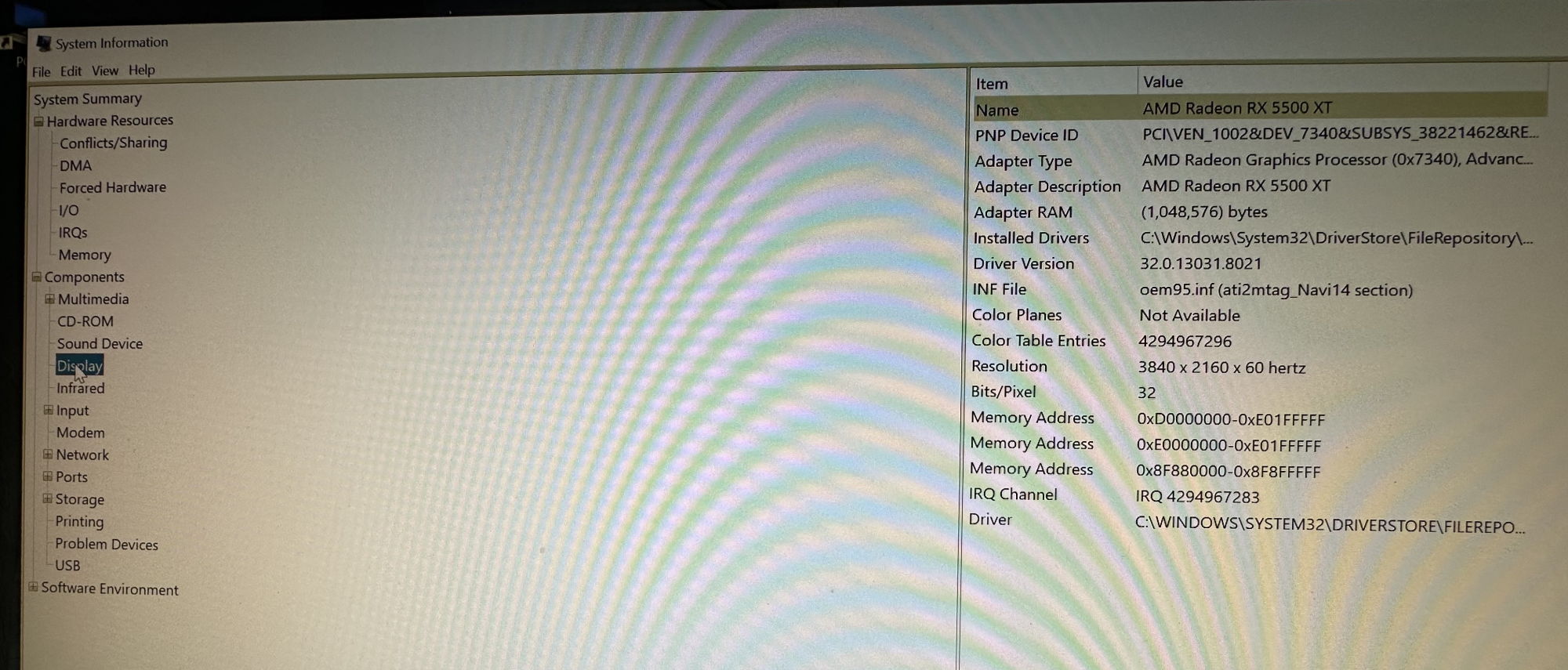

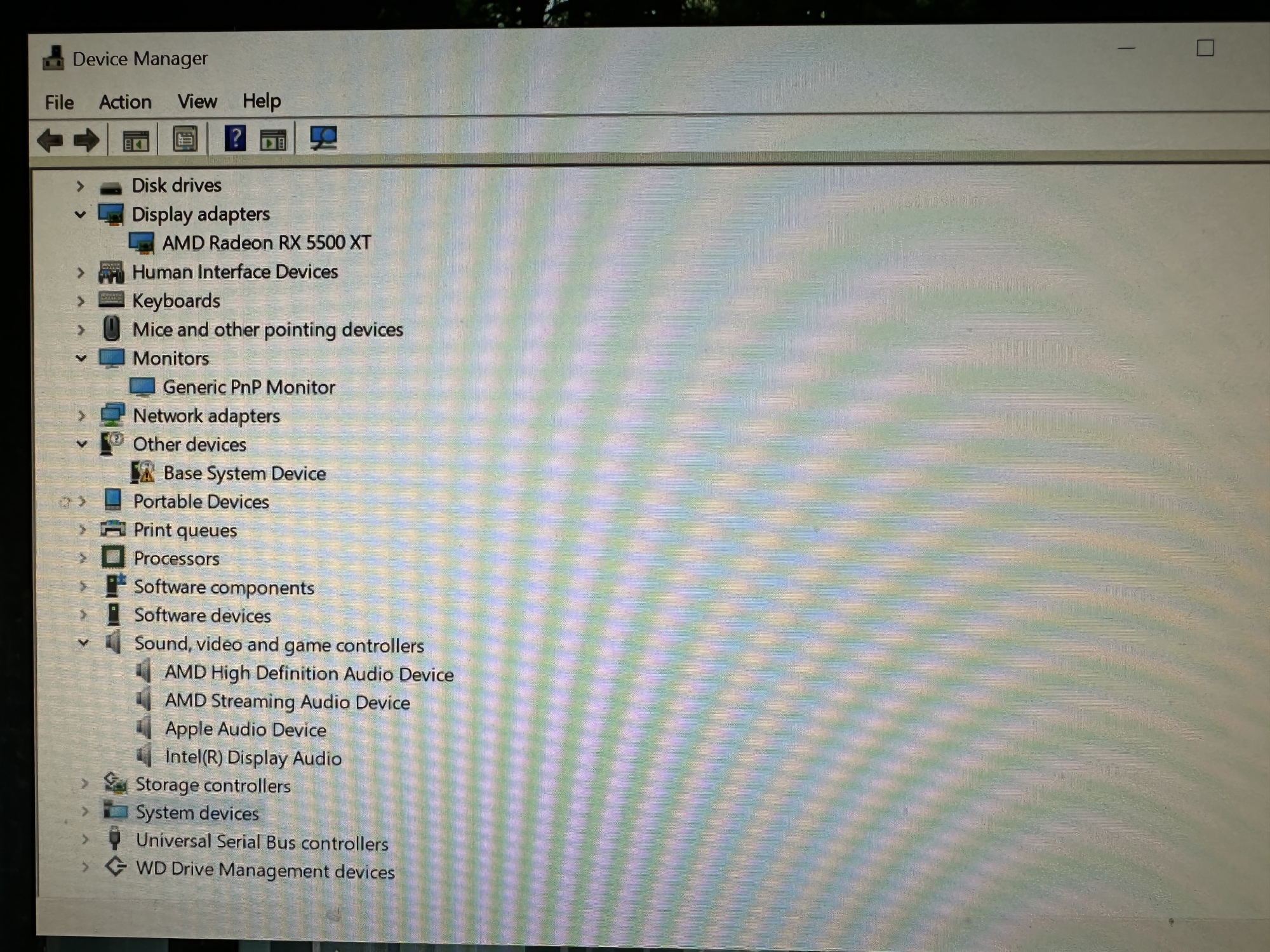

Some screenshots of my eGPU working in Windows 10.
Note: I can´t take any of macOS Sequoia. The second I turn on the switch of my Sonnet, my Mac crashes and the Sonnet turns off.
Hope this helps.
If you need more screenshots of specific menus, please let me know.

Apparently the only curious thing I seem to notice is that the thunderbolt drivers are installed by Apple and they are from 2018. Could it be that I should hit update? Previously, I thought of this, but could not find any trusted Thunderbolt installer. Is this an issue? In device manager I could try to hit the update driver and see if something new comes up. What do you guys think?
Since devices (Mac Mini's and its builtin Thunderbolt 3 controllers) are from 2018, it's not that unusual for the drivers to be of the same vintage. While, I am sure Intel has updated their OEM drivers for the controllers (JHL7540), it's unclear how an end-user such as yourself can get them if not from Apple. If MS has an updated generic for such, those should be fine (though have a rollback plan available).
That said, I doubt those would help your Mac side at all and given the issues you are having in general not sure they would help your Windows side.
What I would look at first is your Radeon drivers. Assuming that is a generic -- not Apple-specific card -- and I am reading that right as you having the 32-bit drivers, I would look to upgrade to the latest 64-bit Radeon drivers for Windows 10.

On the Windows side in Device Manager, can you do View->Devices by Connection -- once when you can see and use the Radeon card and once when it doesn't come up (which I guess is your 9x out 10x situation)? When the Radeon card is working, expand the tree all the way through to the monitor each time. When it's not coming up, show the equivalent part of the tree.

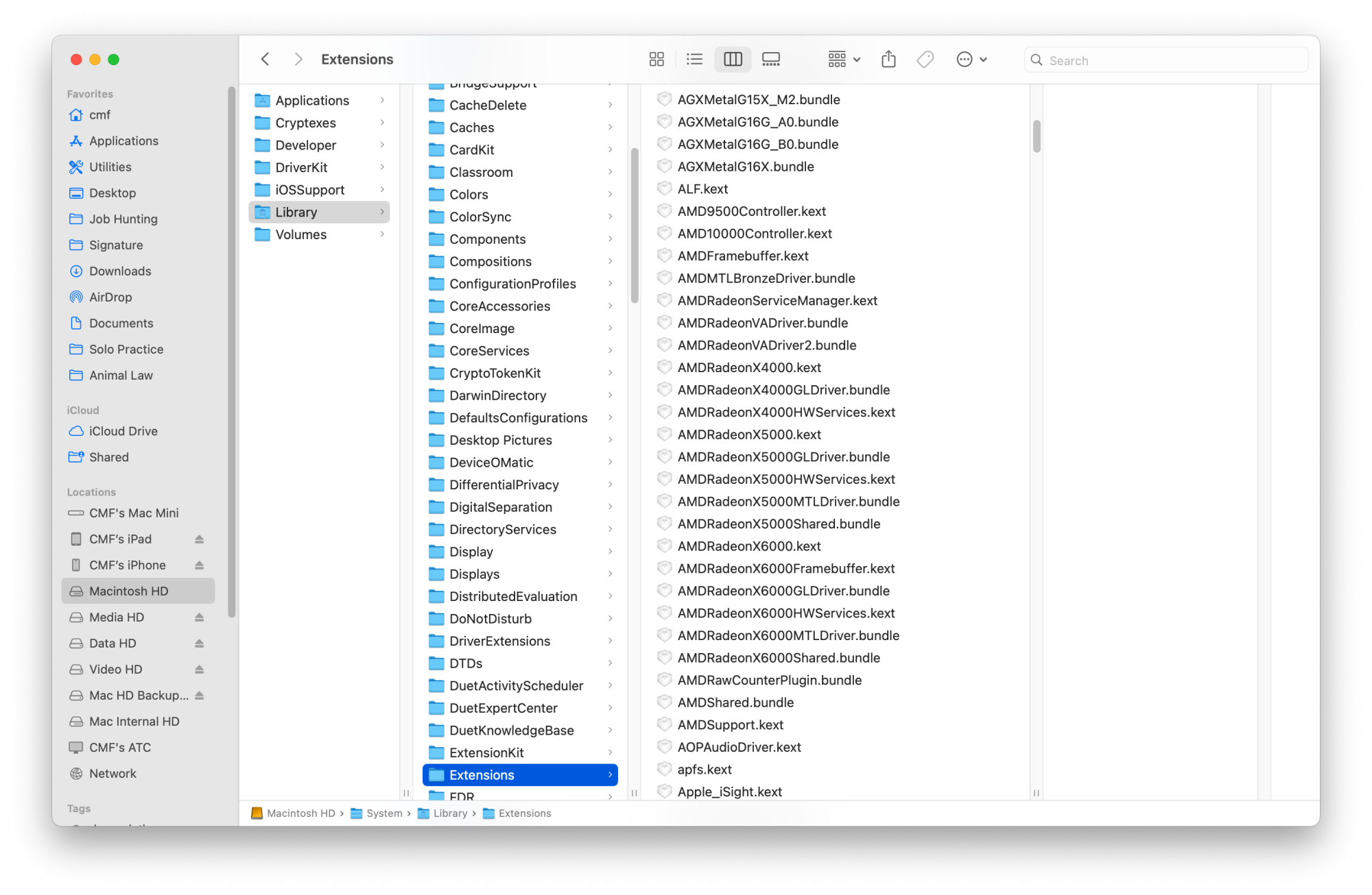

Here are the AMD drives I'm working with.

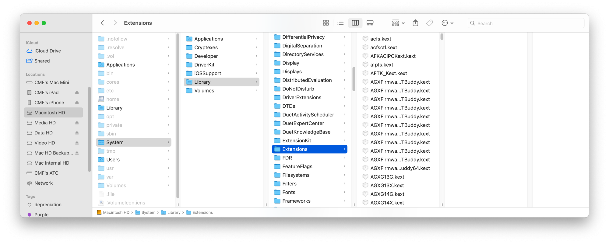

I checked mine *remember, my Sonnet crashes since 15.4 with cold boot and hot plug. So i can only check that same path you gave, without the Sonnet attached. Booting with the integrated Intel UHD Graphics 630.
The extension folder has no AMD drivers at all. I dont know if the Sonnet box has to be recognized in order to be displayed though.
Is there a way to just copy those drivers inside that extension folder and see what happens? Does macOS even allow this? im not terminal savvy thats why i ask.
The location of those drivers are Macintosh HD>System>Library>Extensions.
