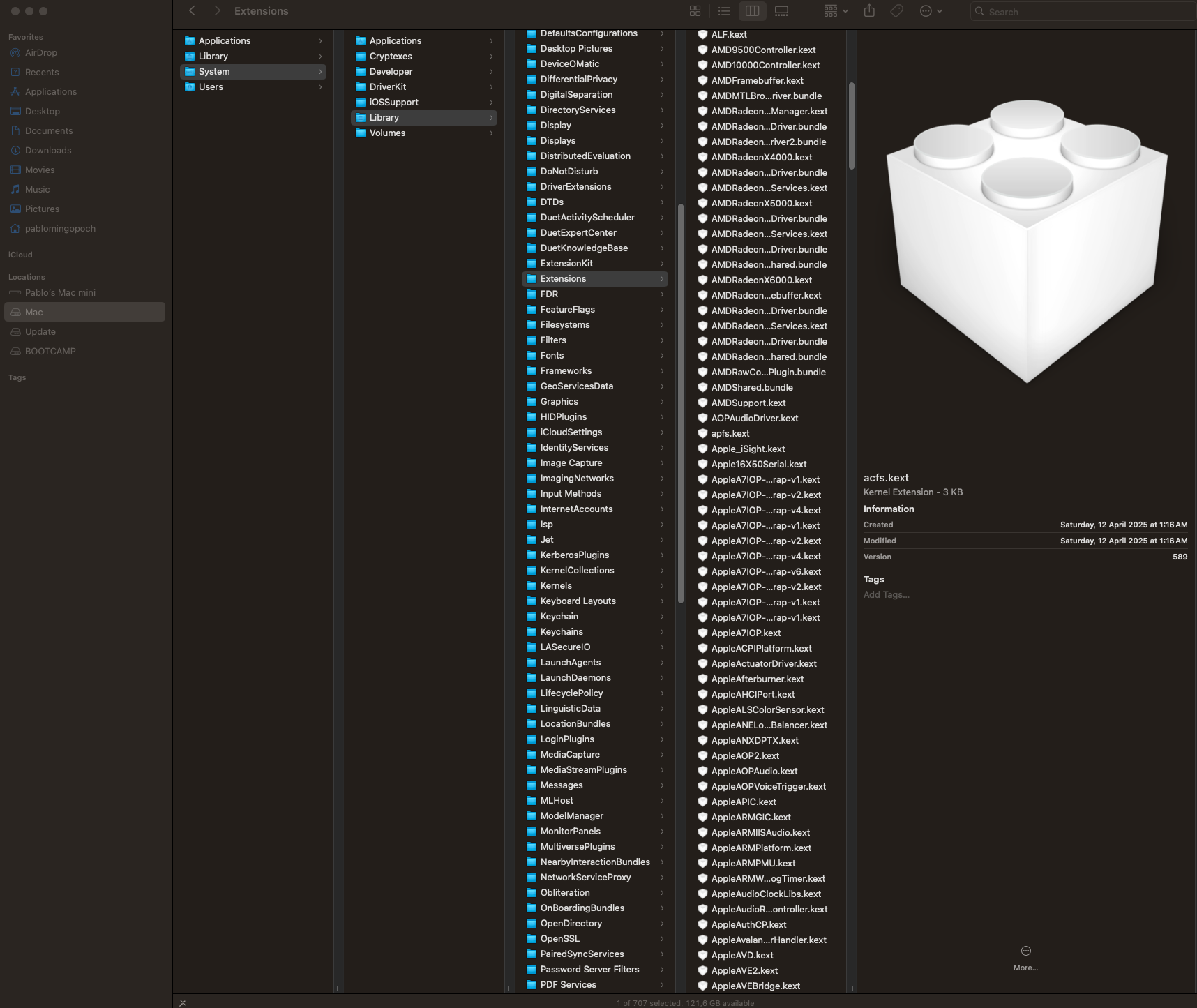

The location of those drivers are Macintosh HD>System>Library>Extensions.
EDIT: Was your eGPU plugged in last time you updated MacOS? If not, I wonder if MacOS failed to install the AMD drivers because the eGPU was not plugged in at the time. That would actually explain why it's working in Windows and not MacOS.
Sorry @Engender I was looking inside the wrong path. The extensions do show up when my Mac is not connnect to my eGPU. Here is a screenshot.
