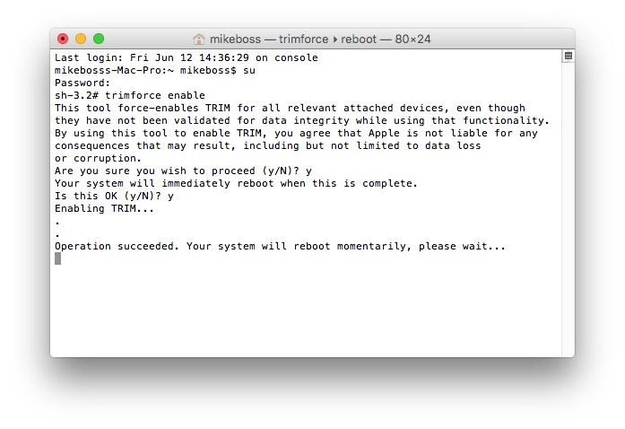

Guys, there is a native way, now. Just enter "sudo trimforce enable" in Terminal.
Edit: Well, it's not yet working correctly, but I guess it will eventually.
Edit2: okay: try this:
1. Disable Rootless (sudo nvram boot-args=rootless=0)
2. Run "sudo trimforce enable" read it's text and do what it asks you for.
3. Enable Rootless again (sudo nvram -d boot-args)
holy sh*t. indeed there's /usr/bin/trimforce. in it it says:
This tool force-enables TRIM for all relevant attached devices, even though
they have not been validated for data integrity while using that functionality.
By using this tool to enable TRIM, you agree that Apple is not liable for any
consequences that may result, including but not limited to data loss
or corruption.
it works!!! TRIM is enabled now 😎
