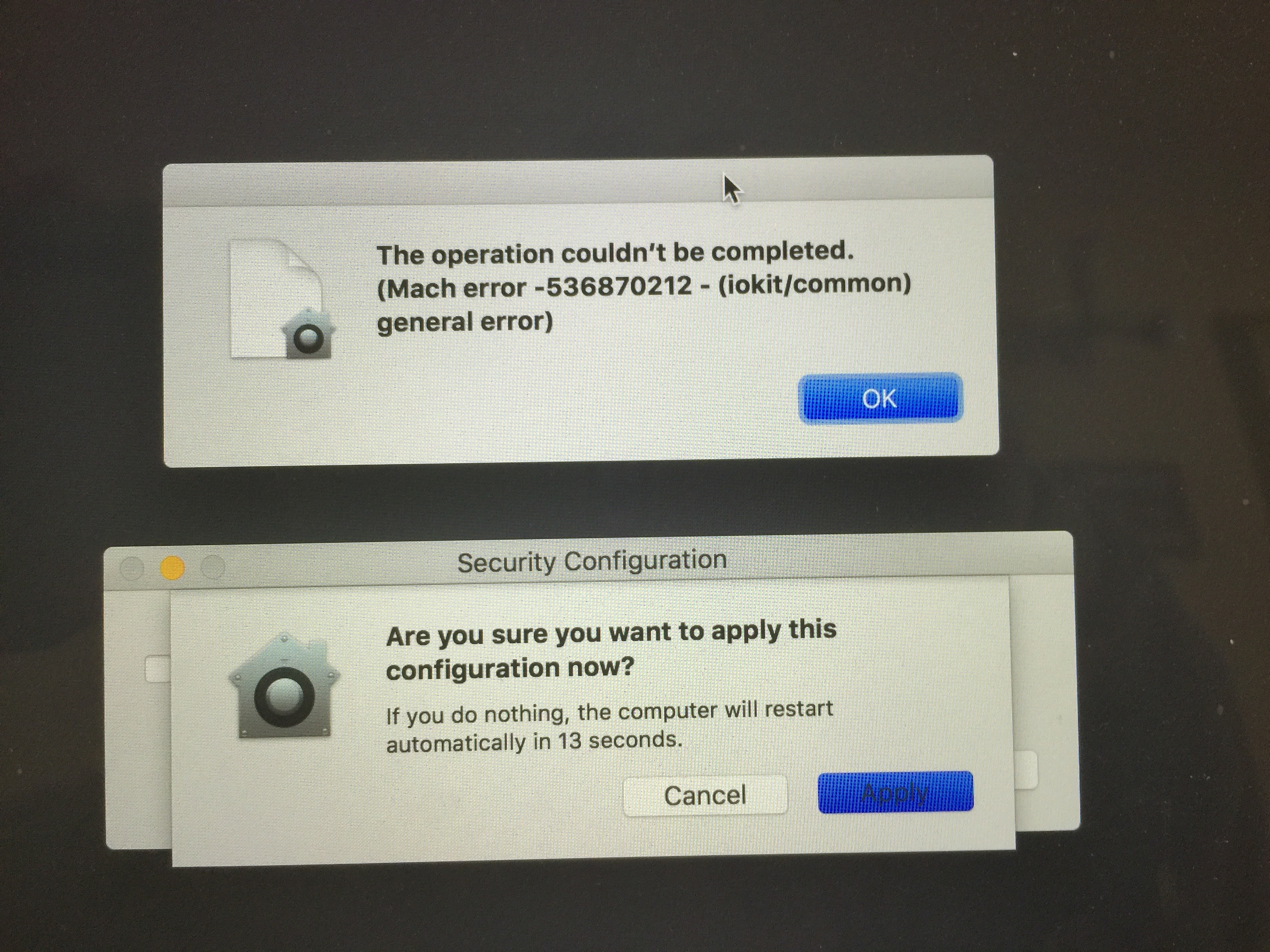

I got this error when trying to disable System Integrity. Your help much appreciated!
Well, i´ve found the solution: you have to reset the pram: hold ⌘⌥PR at boot and wait for restart.
