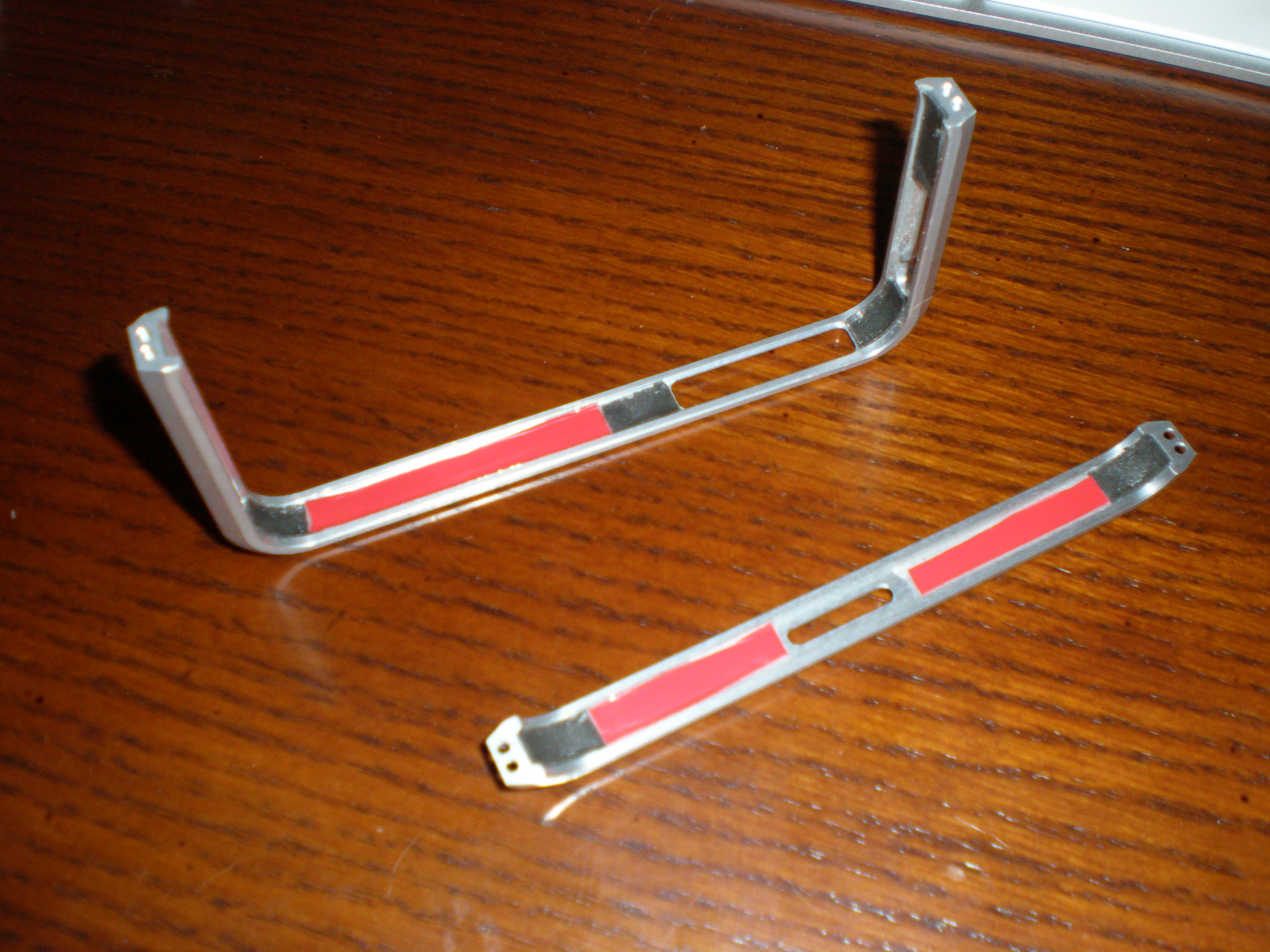

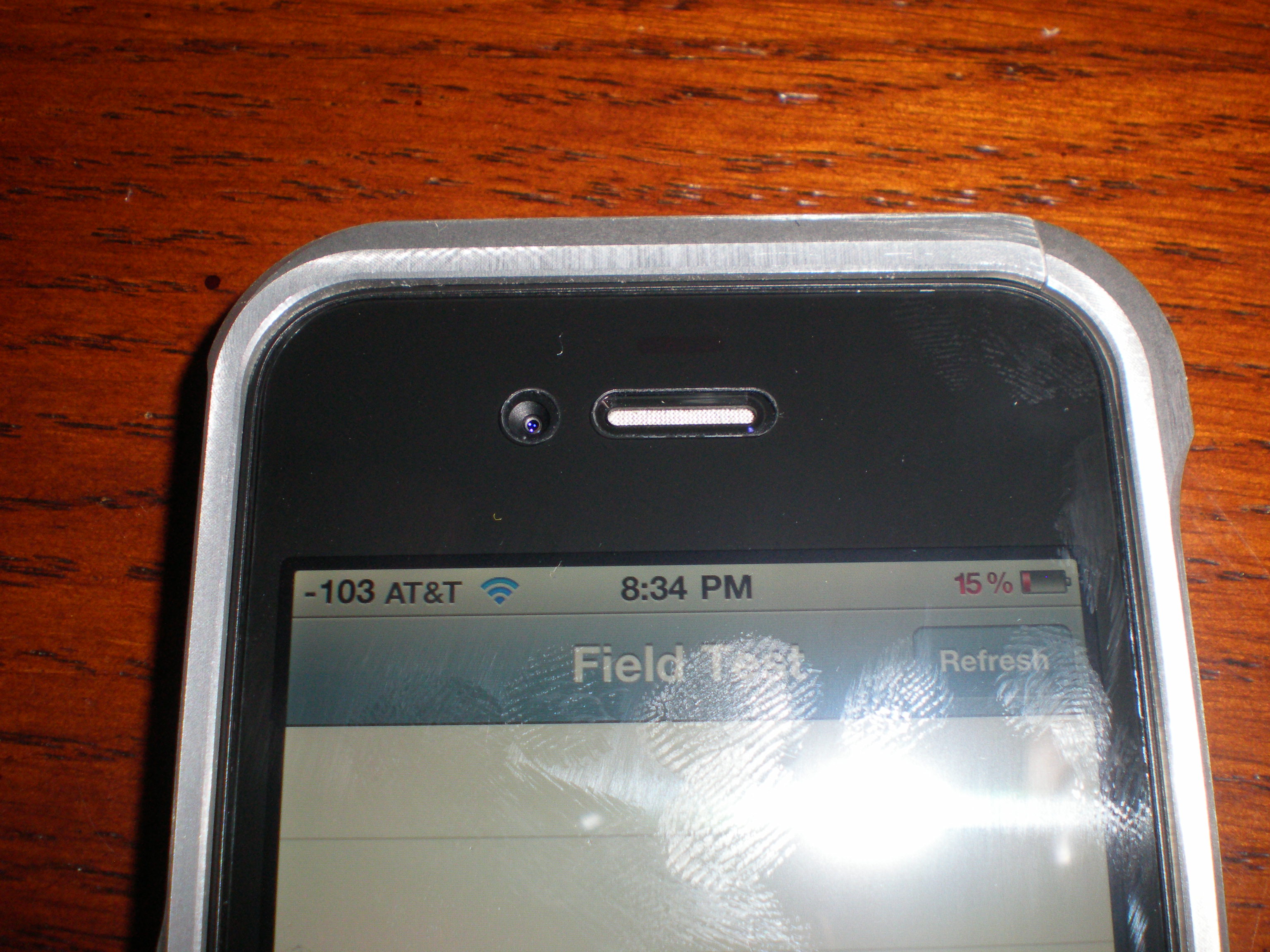

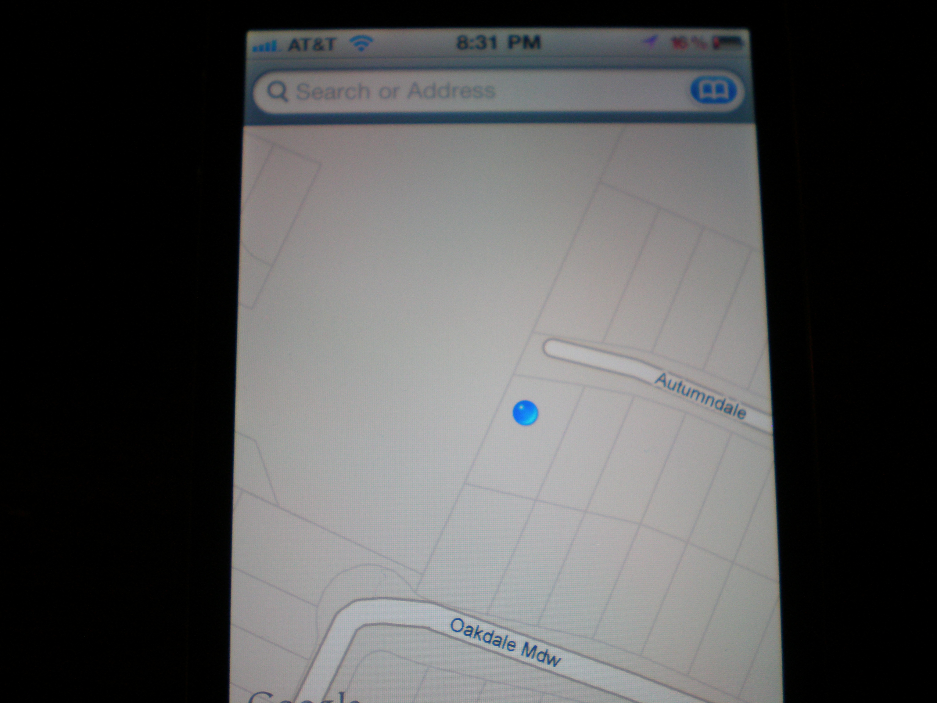

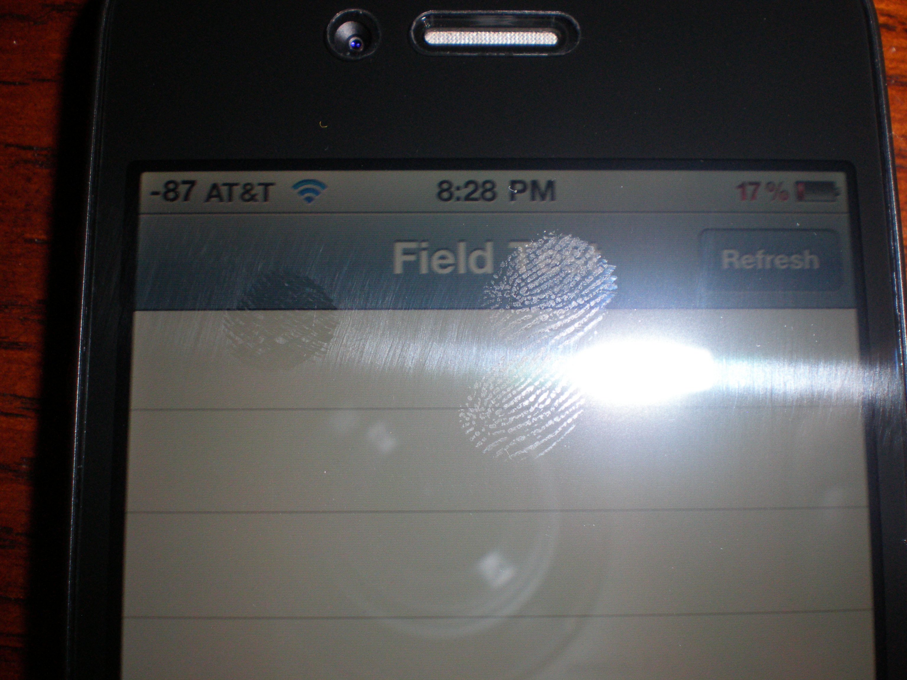

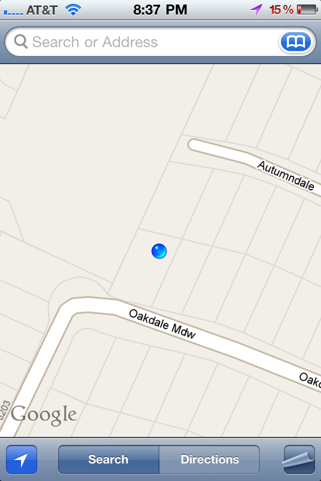

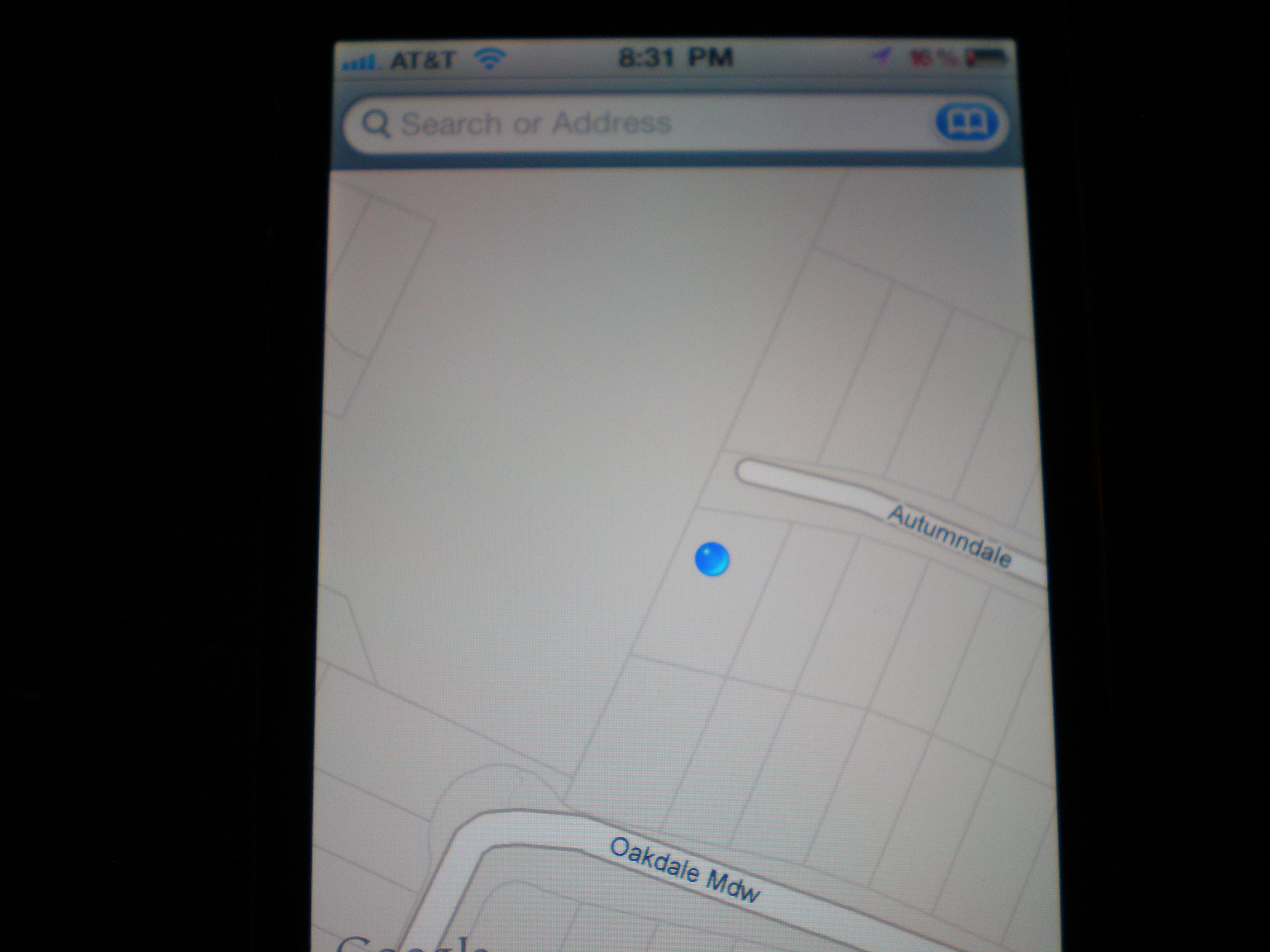

okay so i did some tests and here are the results:
Without ElementCase Vapor 4 Case:
Antenna: -96
WiFi: Ping: 62ms
Download: 5.45Mbps
Upload: .90Mbps
GPS: Perfect
With ElementCase Vapor 4 Case:
Antenna:
WiFi: Ping: 63ms
Download: 5.28Mbps
Upload: .91Mbps
GPS: Off about 100+ feet, varies randomly.
1st picture - what I did with the 3M Scotch adhesive tape.
2nd picture - GPS w/o case
3rd picture - GPS w/case
4th picture - Signal w/o case
5th picture - Signal w/case
Hope this can help provide feedback to people considering this case. I tried w/o the insulating tape and the results for GPS and WiFi were the same. The only different I noticed was with the signal which was much worse than with the 3M tape. (around -115+)

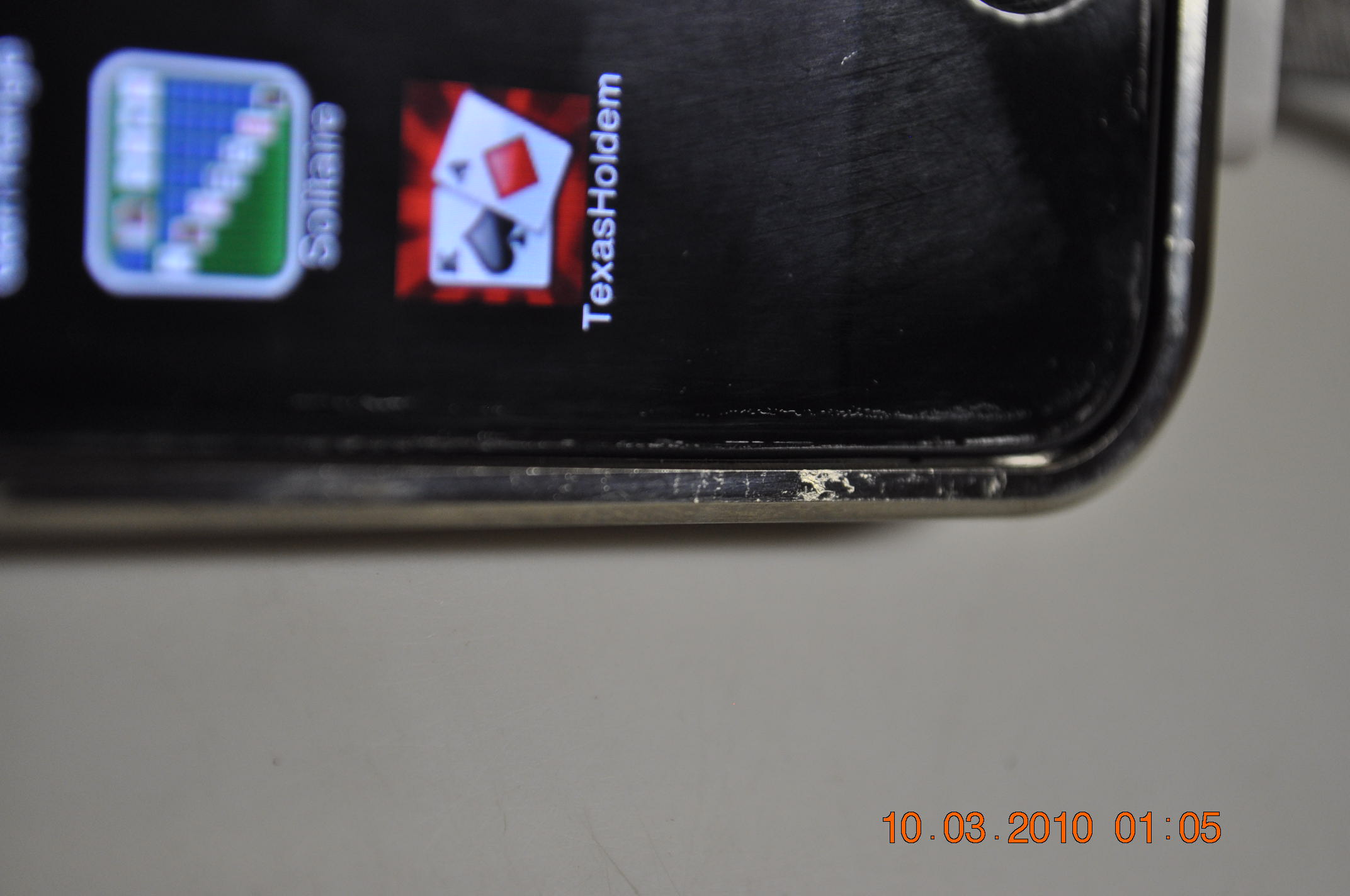

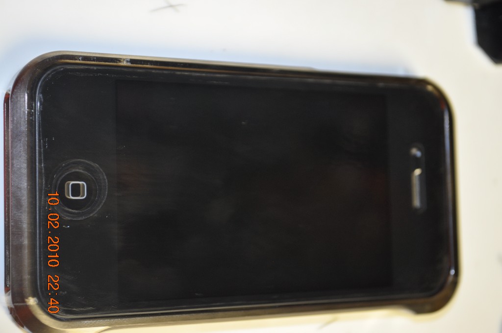

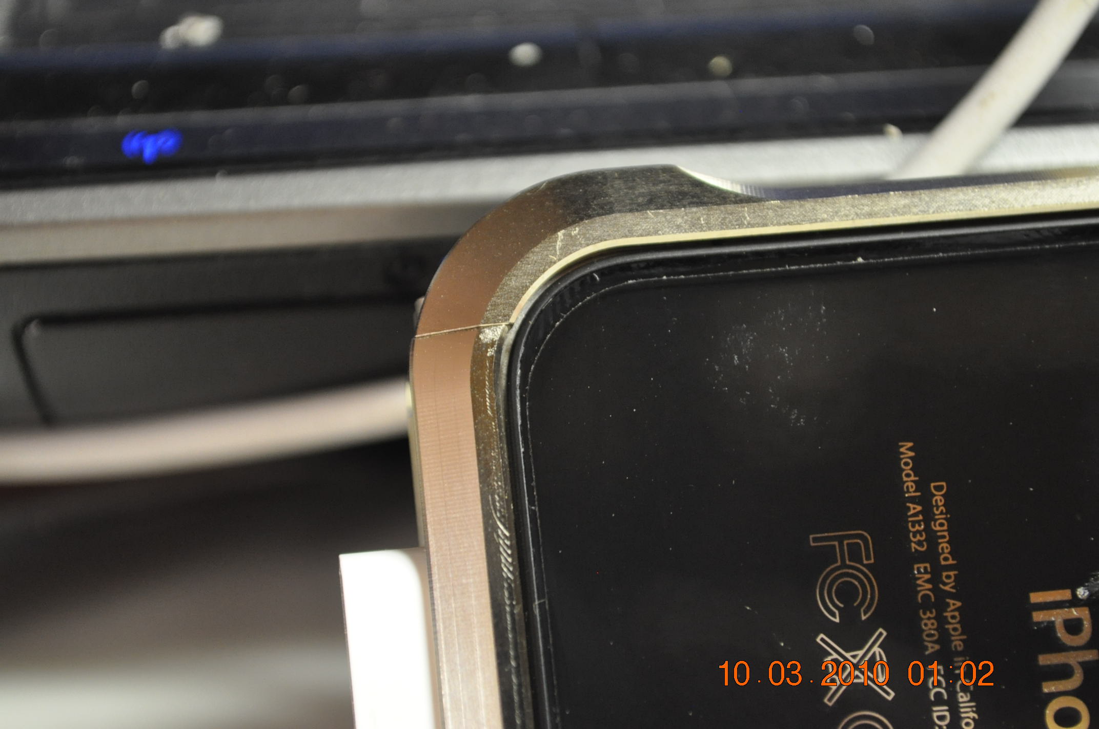

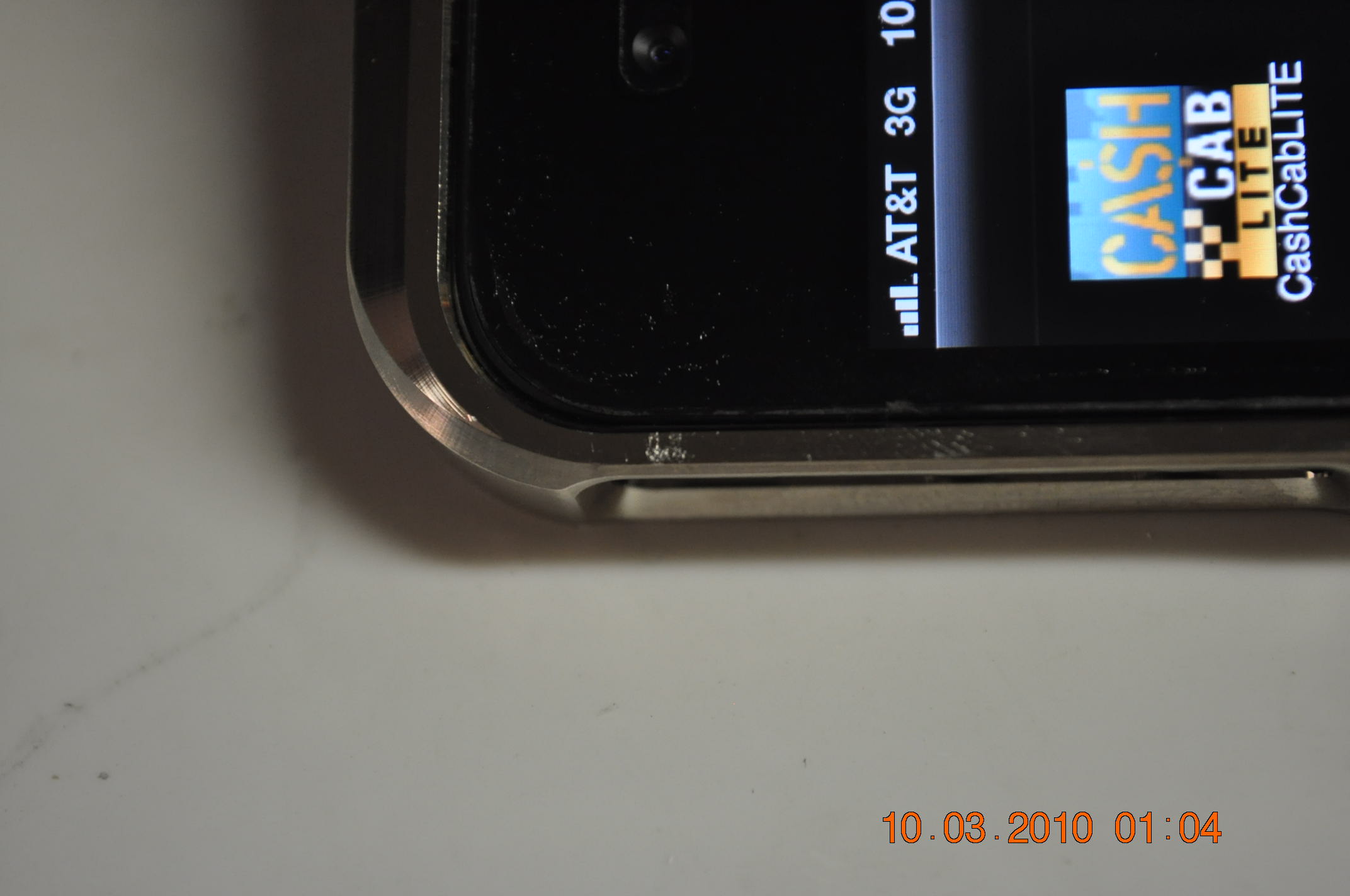

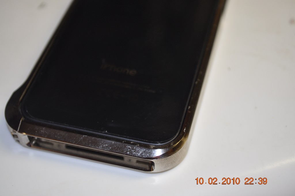

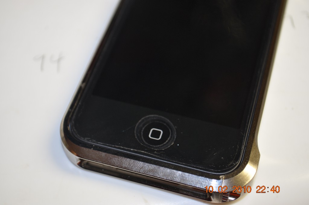

I just got my element nickle plated case and the front and back have some spots that look like pitting and are not removable. Has anyone else had this same finish problem? Overall the machining is bad a$$ but the nickle plating quality leaves much to be desired. Has anyone had this problem with the anodyzed finish? Could this just be a one time mistake on my particular nickle finished case? See particularly the joints between the two pieces. The bottom pic shows it the best where the seam is and the opposite side of the case there are very deep pit that can be seen in the pics. Honestly, it looks much worse in person than I can show in the pics. Im thinking of stripping the nickle off myself and just polishing it down to the aluminum to a mirror finish. BTW these pics were taken literally 20 minutes after I opened the package and not after a day or two of abuse. I treat my phones like a dozen eggs.

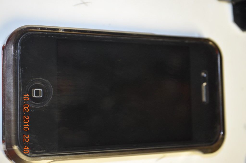

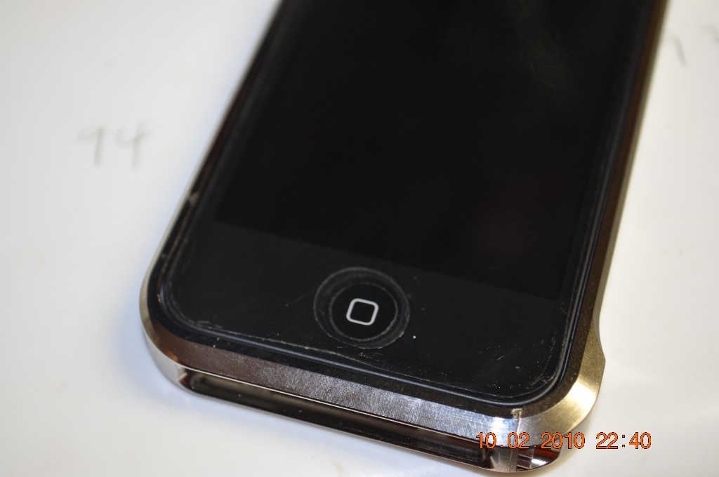

I just got my element nickle plated case and the front and back have some spots that look like pitting and are not removable. Has anyone else had this same finish problem? Overall the machining is bad a$$ but the nickle plating quality leaves much to be desired. Has anyone had this problem with the anodyzed finish? Could this just be a one time mistake on my particular nickle finished case? I will post some pictures once my Nikon is charged.
usmc1775 I hadn't heard of any EC anodized case problems. But there have been reports of the extreme nickle cases tarnishing, which is natural for nickle. But you may have a bad one 🙁. Lets see the pic's.
My anodized silver was scratched/pitted on the cap piece. I'm sending it back for a replacement. Customer service was prompt in replying. We'll see how quickly I get the replacement part....

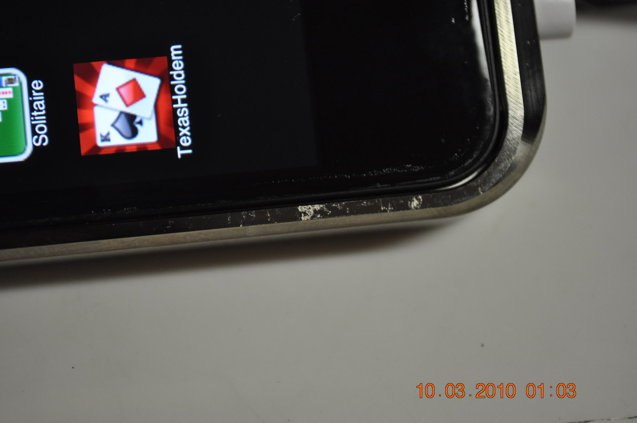

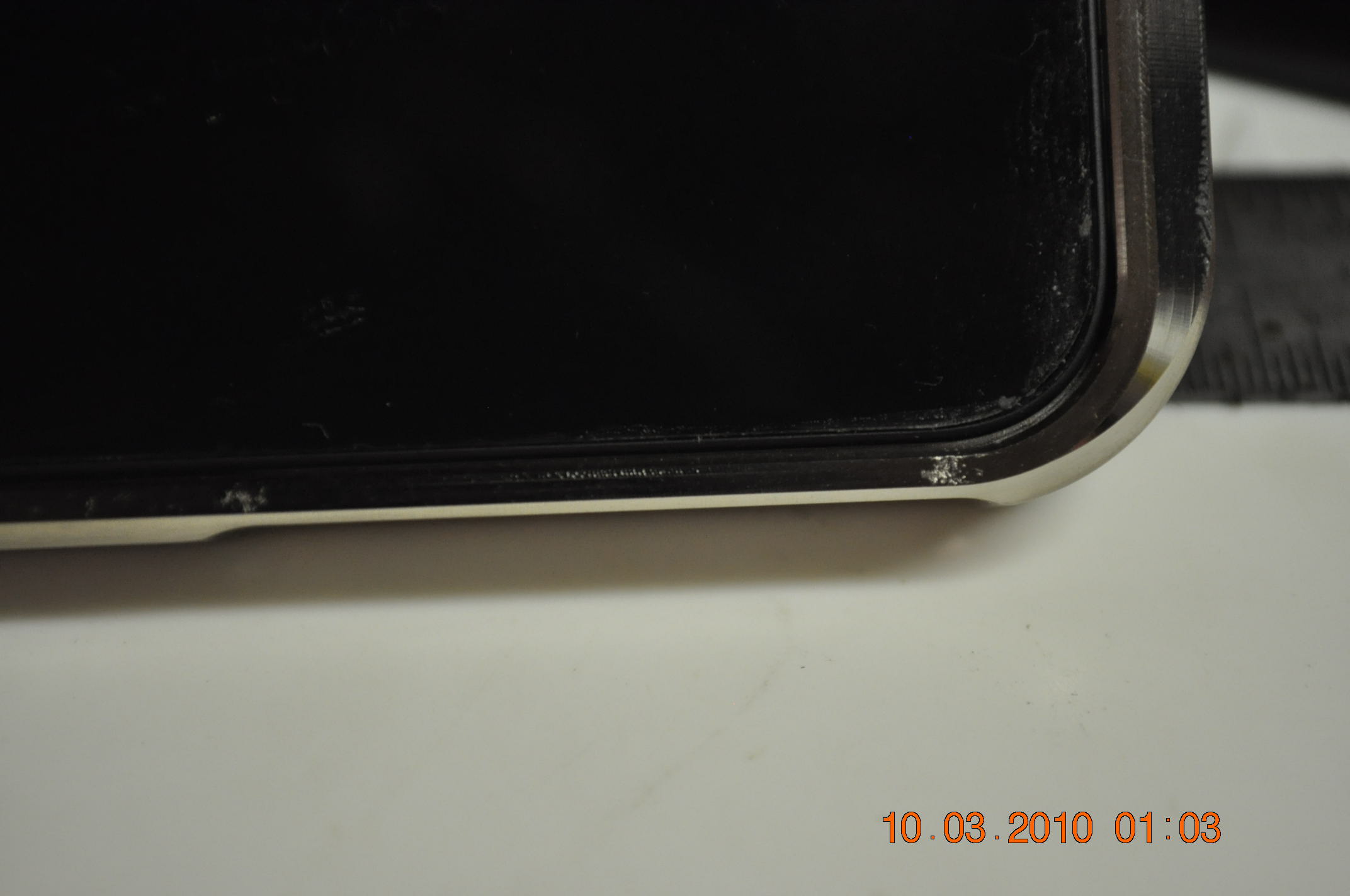

Here are some more and better pics of the blemishes
Dude. Contact Element and send them the pics and get them to send you a new case of your choosing. That case looks really bad. Everyone has been saying they are having tarnish problems. I don't think Element thought this case through enough. If you try and make adjustments to the case they might not take it back.

I had no such issues. I'd not thought it would tarnish, however it does 'wipe off'. EC say removing the tarnish will not affect the finish. I also think it will add a little character. The sort of 'character' I can accept, as opposed to the scratched / chipped screen 'character' you can get 😉
My Nickel case did not have that that pitting. Looks like a manufacturing defect.
After living with the tarnish for a couple weeks, I decided to send the case back for a different finish. I wouldn't mind if the tarnish was fairly consistent all over the case but it was very uneven and mostly in the areas that had the most contact with skin.

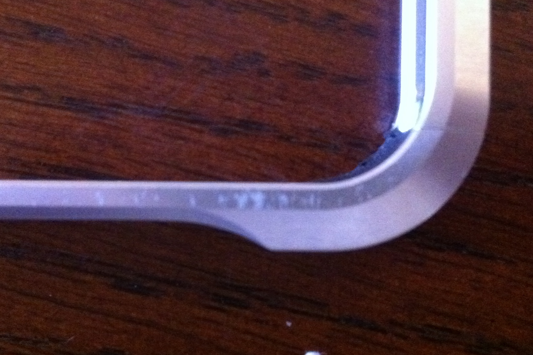

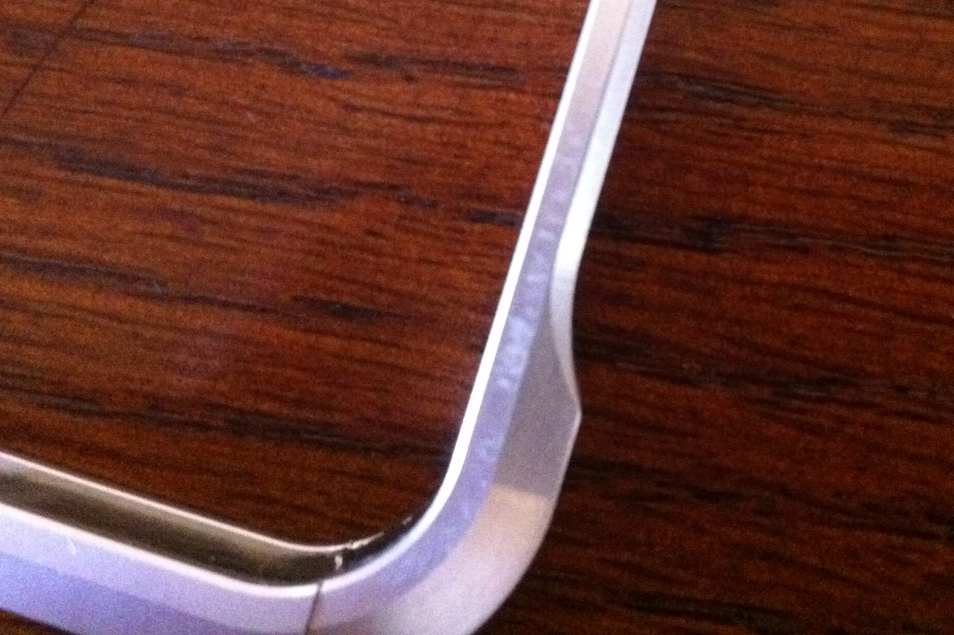

Thought I'd post a couple of pictures of my silver/silver anodized cap which had the pitting/scratches. Looks like it was a return almost, however, the rest of the case was perfect. I am going to contact their returns department, because I started thinking about it, and me spending my money to send them back their faulty product is BS. They should provide a replacement part and a prepaid label for me to return the faulty one. Will let you know how it turns out.
Sorry about the quality, wife took the good camera out of town this weekend.
Hi,
This looks to me very much like the aluminium has corroded slightly before the plating treatment was applied.
I work with anodised aluminium products and see this often.
Corrosion of raw aluminium will appear as 'pitting'
Whether the corrosion occurred after machining or before is unknown but either way should have been spotted long before it made its way to you, the end user!
Definitely return it 🙂
