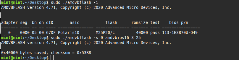

Meanwhile, I have gathered together all the things I will need to do the flash. Using a Linux Mint live USB. Did a diagnostic and a dump. Does this information help?
The dumped rom file gives the same md5 hash (using the Github tool) as the original version on TechPowerUp. Well it should, but reassuring to know. I assume it's not significant that your file and TechPowerUp's have a .rom filetype whereas the AMDVBFLASH dump has no filetype extension?

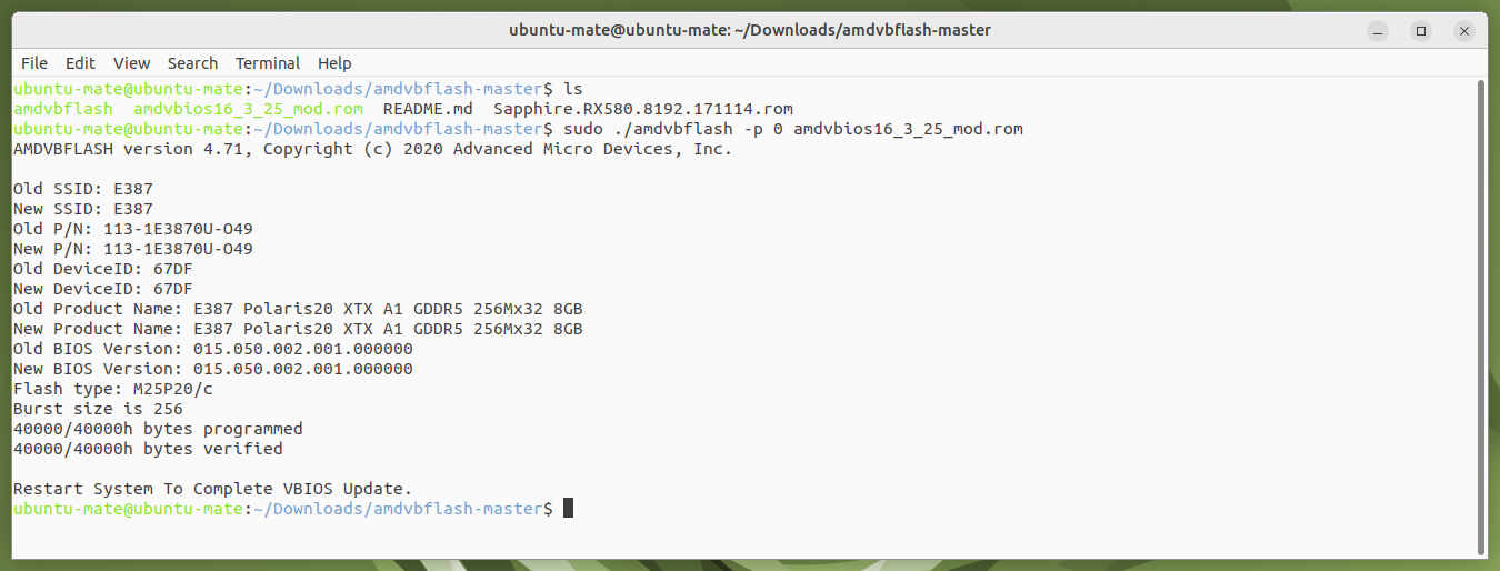

Success!!
Oh you clever clever people. Take a collective bow everyone whose input made this possible.
Thanks to Ausdauersportler who provided a required ingredient and especially to Borowski who generously shared his time and effort assembling the final product which I would not have known how to do.
Amdvbflash reported no problems. Indeed, it doesn't seem to see any difference between the new bios and the old.

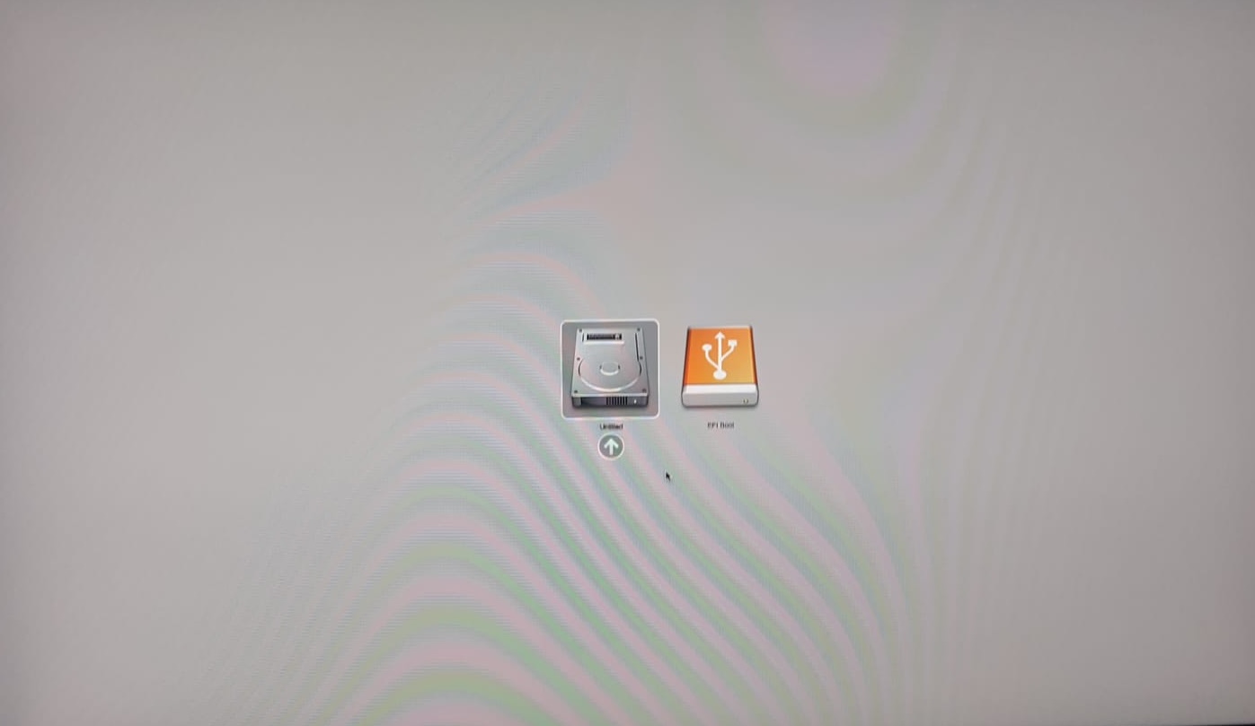

And then the holding-one's-breath moment. The alt-key reboot!
Completely brilliant. I really am impressed. My thanks for generously sharing your skills.
Usually older versions read the information only from the vbios-image and that remains untouched. For AMDVBFLASH it seems totally identical.
I only added (inserted) the GOPEnabler and didn't need the "short" GOP image found by "Ausdauersportler". But for future usage may helpful, perhaps s.o. will edit the automated script for AMD, avoiding to break the 0x20000 byte border.

Well thanks anyway. The old cMP feels much more useful now. Already got Ubuntu Mate 24.04 as a boot option. Couldn't do it before.
Will look into SteamPlay for gaming. If I read correctly this may obviate the need for Windows. No great loss in my opinion.
