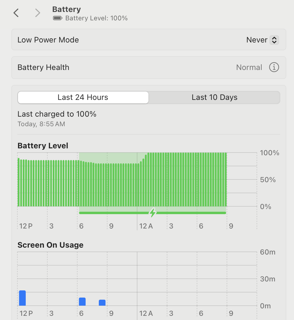

My M2 Air was at 92% when I plugged in the charger. A couple hours later the charge is at 80% and holding. The charge will increase to 100% about 06:00. Being on the charger the M2 Air actually discharged during those two hours while I was not using the device.
It appears the MacOS does a good job of maintaining the battery without 3rd party apps. Additionally, does anyone really know if the 100% level is really 100% of the battery capacity? Does the MacOS firmware keep the battery at say 90% of actual capacity which MacOS reports as 100% available energy?

Strangely, my MBA only charged to 100% this morning at 6am like yours 🤔
Mine has done this charge process several times. When it does this I have not fully figured out. What surprised me was discharge down to 80%. The M2 was not in use same as the prior period in the graph. Basically no discharge. I plugged in the laptop, closed the lid and did not open until this morning. What caused the discharge is unknown.

Batteries should be “worked out” to stay healthy. You don’t have to work out every single particle of the cell, just move some then move others etc.
All batteries, practically, work by moving electrons to form and break up molecules. I imagine that “wear” is a result of the fact that no chemical reaction is really 100% efficient, thus the chemicals you have at the start won’t exactly be the same chemical elements in the end. There’s no loss of matter but it may have combined into something else or not reacted at all.
By discharging the battery to 80%, the Mac forced the Lithium to shuffle around from cathode to anode and back, thus giving them a workout but not to the extent of a full discharge. I have seen lithium chargers advertise a “battery tender” mode that essentially does just this: a shallow re-jiggling of the molecules to keep them plastic or homogenous.
I’m not a chemist but this Sesame Street level of understanding is good enough for me 😅 I just want my “Charge Fully Now” button back
