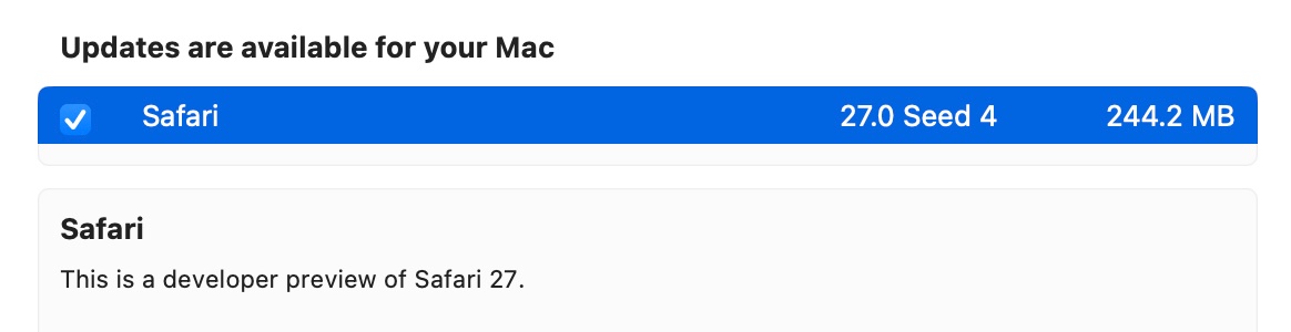

I don't know why, but I have version 27.0 of Safari installed, running Sequoia 15.8, installed OTA yesterday.
Safari info says it was created August 7. Quite different, compared with Safari 26.6.1. I wonder why there is such a discrepancy, and the date is so far back in time, almost 2 weeks.
That should be a beta version of Safari.

You have installed a beta version of macOS (15.8), it’s normal to receive Safari beta updates in Software Update.
Interesting. The 15.8 update appeared for me a few days ago. I've installed it: Sequoia 15.8 (24H16). It appeared in Software Update tho I have beta updates off. There doesn't appear to be a full installer available either, after checking using Terminal.
I''m now showing Safari 27.0 Seed 4 in Software update.
Maybe because I have the Develop menu on in Safari?

No, having the Develop menu in Safari does not make beta versions of Safari to appear in Software Update.
You are definitely enrolled in the developer beta program. What does this command return:

sudo defaults read /private/var/root/Library/Preferences/com.apple.MobileAsset.plist
LastUsedBackgroundSessionID = "com.apple.MobileAsset.networking.background.v2";
MobileAssetAssetAudience = "c8ba02c8-cc63-4388-99ee-a81d5a593283";
"PallasUrlOverrideV2-com.apple.MobileAsset.Trial.Siri.SiriTextToSpeech" = "https://gdmf.apple.com/v2/assets";
That is the value for "macOS 15 public beta": "c8ba02c8-cc63-4388-99ee-a81d5a593283"

Aah! I see now. I didn't read the fine print so to speak when applying the MobileAssetAssetAudience command. I had not seen any previous public beta updates come up in Software Update prior to 15.8, so didn't realize until I re-read the previous posts that the potential was there to show those while all along hiding Tahoe.. Thank you 🙂
