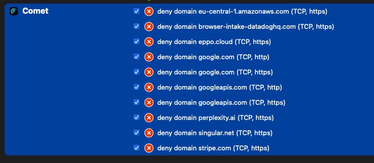

I kept the Go-Away-Tahoe, removed the blocked nurlsessions updates in LS and it downloaded and installed well

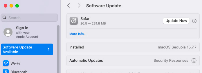

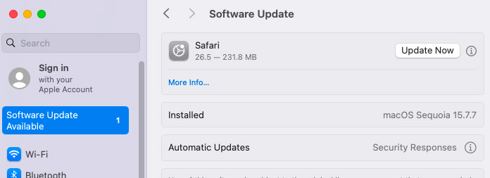

I'm seeing Safari 26.5 offered for OTA update in System Settings. Have you tried updating that way?
BTW, I'm seeing Safari even though I have Go-Away-Tahoe still set, but I haven't tried to install yet.
Yes, I have the Safari 26.5 update choice showing, same as before updating Sequoia.

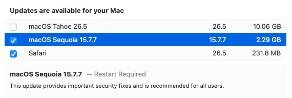

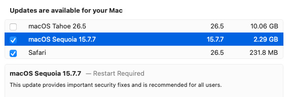

I successfully installed Safari 26.5 after removing Go-Away-Tahoe. The same old "dark pattern" was in use - I clicked the (i) beside Safari and found that both Safari and Tahoe were checked for installation. You have to be careful! After unchecking Tahoe, the Safari install worked fine, after which I reset Go-Away-Tahoe.
Reactions: Davidson Powell
I saw the same, but made a test and clicked on Update Now. I was prepared to turn off the Internet 🙂, but only Safari was installed. As there is no guarantee about what is supposed to happen, it's probably best to click on (i) and uncheck Tahoe just to be sure.

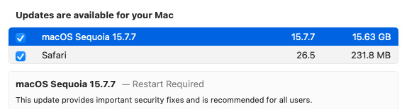

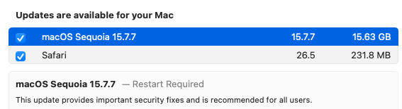

I’m sorry, please disregard my previous post. It took me a while to set up a new virtual machine and test the idea.
Unfortunately, when the value for the public beta channel (c8ba02c8-cc63-4388-99ee-a81d5a593283) is set, Software Update shows the full installer, not the smaller OTA.
15.7.7 with 8ba02c8-cc63-4388-99ee-a81d5a593283 15.63GB
15.7.7 OTA 2.29GB

This one is working for not showing Tahoe, but the red icon still there because Safari 26.5 is available, how to completely get rid of the red icon and staying put with Safari 18.6?
Thanks.
Reactions: sinbad21
Code: (one line)
sudo defaults write /private/var/root/Library/Preferences/com.apple.MobileAsset.plist MobileAssetAssetAudience -string Go-Away-Tahoe
Thanks.
Why staying with an old version of Safari? You can use Safari 26.5 with Sequoia, and the red icon will disappear.
