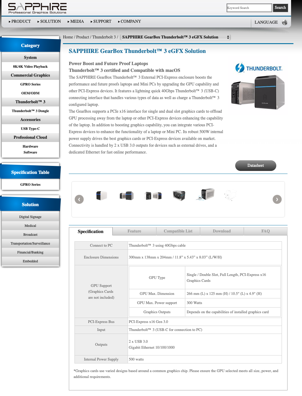

Sapphire, one of the AMD "partners", has started selling an eGPU enclosure. MSRP is US$330, but Amazon is selling it for $260. It's also being sold bundled with a Sapphire RX 580.
Overview here: https://egpu.io/forums/thunderbolt-...apphire-gearbox-thunderbolt-3-egfx-enclosure/
The screenshot below is from http://www.sapphirepgs.com/productdetail.asp?IDno=121&tag=spec&lang=eng
