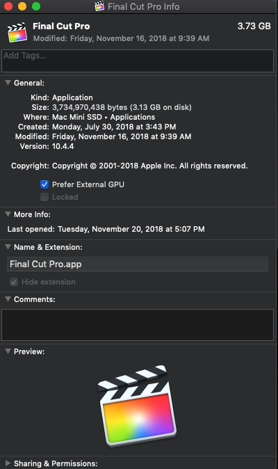

I've checked the box "Prefer External GPU" in the Info panels for Final Cut Pro, Compressor, Lightroom, etc. (see photo).
Interestingly, this box appears to be available for every Mac application and every third party application that I have on my computer (e.g. Adobe apps, Carbon Copy Cloner, etc.), with the notable exception of the Photos app.
My assumption is that only certain apps will use the external GPU, but I certainly don't claim any expertise on this. Also, as far as I can tell, enabling this has to be done on an app by app basis. There does not appear to be a global checkbox in, for example, System Preferences.
I'll have to do some hunting around to see if I can find out what "prefer" means.
