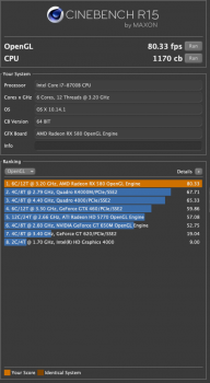

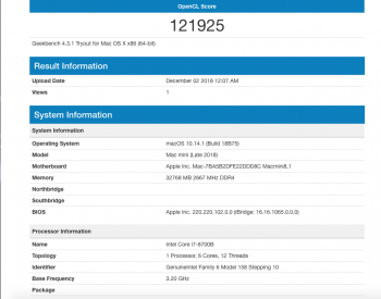

Have a 2018 MM i7,32,500 with the OWC Helios FX W/RX580. Connected with a OWC 3 foot thunderbolt cable. Put the card in it. Hooked it up with a fast Hdmi and it works fine. Changed the cable to a DP 1.4 cable also works fine. No issues with start up screen. Running on a LG 34 Ultra Wide and worked on my LG 55 4K TV with the fast HDMI also.
Plan on updating to a Vega 64 once the manufacturers get up to speed with Metal. Or Mac Embeds move native drivers. Think the Helios Fx should handle it. Felt there was to much Mac Tax associated with the Black Magic and the delayed release made go with the FX box.
Here are a few benchmarks
Great to see more input on the OWC Helios/RX 580 combination. @NerdsLTD also went with the Helios, and, like you, is happy with its performance (see post #150).
