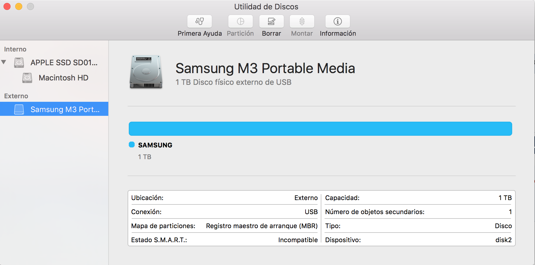

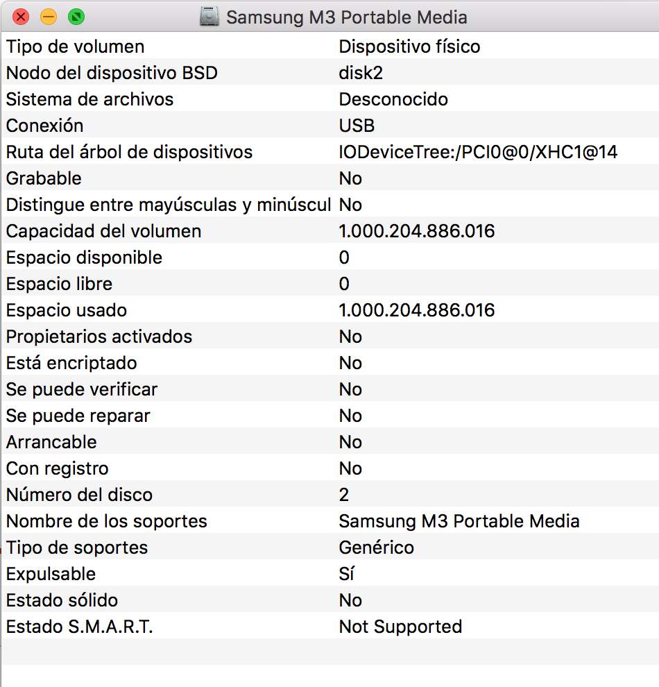

hello!! I have a problem here and i am going crazy I'll show what happens to me and the external hard drive i have (samsung)
I don't know what to do to be able to use it. Hopefully someone knows what is going on
