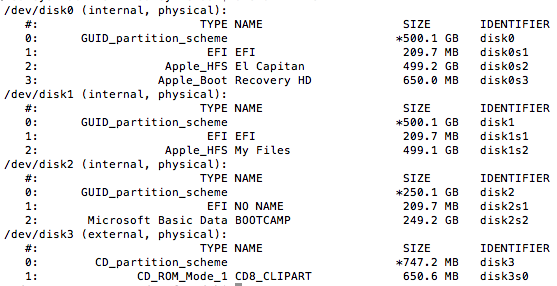

Could you please connect and power up all the drives in question and after some 10-20 seconds fire up the Terminal and enter

Here is the readout. Note my 500GB Time Machine USB drive is not in the list. it's icon is also not showing on the desktop.

OK. I've read about an issue of disks not being shown in GUI apps, but them being available in Terminal. Seems it's just not the case, as there are none.
Do you have any other Mac available to plug the disk in and check if it's recognized?

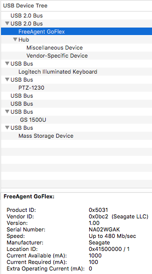

Not sure if this will help diagnose the problem, but my Time Machine USB drive (Seagate FreeAgent GoFlex) is listed under System Information. However, the drive still will not mount in El Capitan.

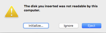

FWIW it seems you have lost the partition. I have no idea why, but I bet $5 it would work flawlessly if you clicked this dreadful "initialize" button (and lost your data on the external disk in the process).
