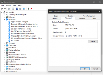

@V-l-a-d-i-m-i-r Hey, so I decided to take a break from using the Magic Trackpad for a while. I wiped my SSD and clean-installed Fall Creators Update on Windows 10 and was just getting comfy with it. Today I tried getting the Trackpad connected again and also decided to try and set up ExtraMagic. It worked (I hope it doesn't reset my settings again and stop communicating with it like it was...). However, the interesting thing is that a couple minutes after I got ExtraMagic to work, I realized that I didn't even have that approved USB Bluetooth dongle plugged in at all (nor did I plug it in since I've wiped the hard drive)! Somehow the trackpad is working fine on my built-in Intel Bluetooth technology. I'm not sure how it's working since, 1) it wasn't working before. And 2) You said that Intel bluetooth had problems (or something like that) with ExtraMagic working. So I'm confused but also happy about that.
I've included a screenshot of Device manager and Intel's bluetooth properties in case you found that interesting.

@dAKirby: Thank you for the feedback, much appreciated! Probably your Intel Bluetooth was at first incompatible because of the Intel software (not because of hardware!) So, new drivers shipped with Fall update can be more compatible. Every Bluetooth on every PC may have its own good or bad surprises. While all Macs produced after 2009 are always compatible: Windows 10 via Boot Camp, Magic Trackpad 1 or 2, ExtraMagic software - such combo shall always work.

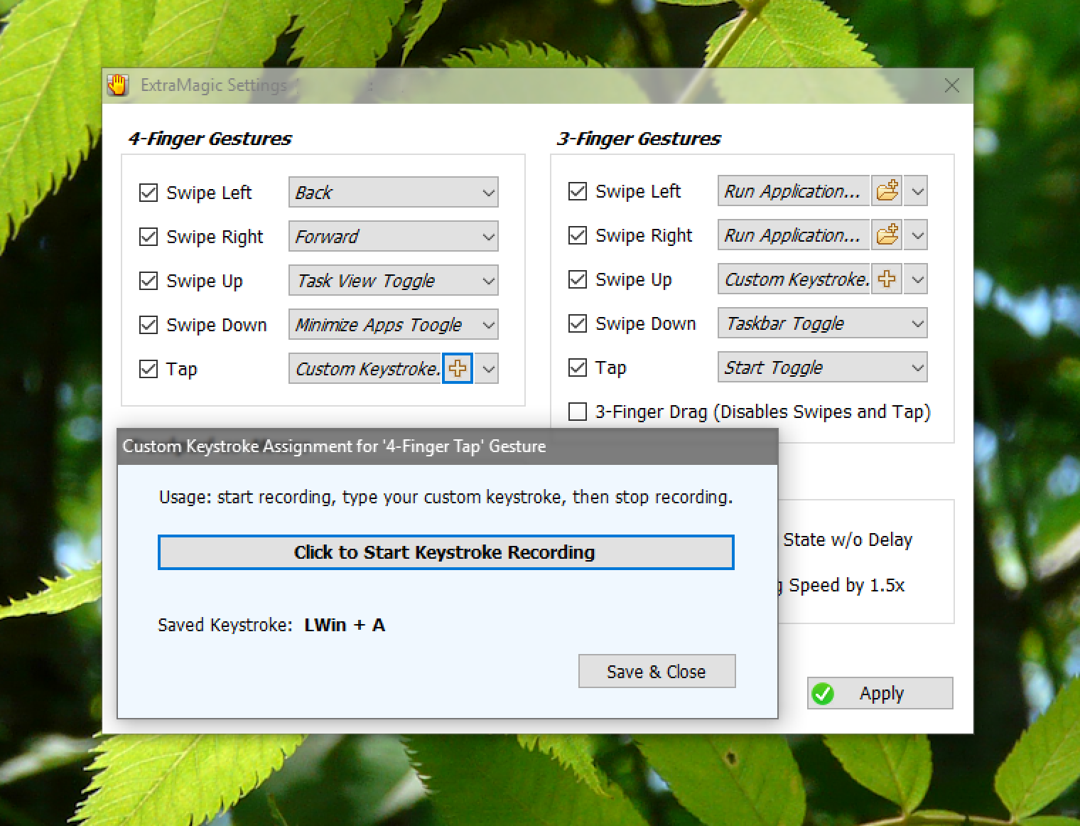

Screen shot of the new feature:

Hi Vladimir!
I have downloaded and started testing this new version. I am not using a Mac for this yet (I will be soon) but I have installed the drivers and whilst the gestures work, I cannot record a key combination using the new feature.
No matter what keys I type, even using the on screen keyboard, they do not register like they have in your screenshot.
Do you have any suggestions?
I am running as an administrator, I have tried turning of Hyper-V and UAC but to no avail...
I am not using the signed version of the app, but maybe that would be worth testing?
@GregAndo: Hi, thank you for reporting. As this feature works for us (tested on 2 PCs and 2 Boot Camped Macs), it's difficult to tell. The custom shortcut recording feature should work regardless of secure boot, signed driver, or special user privileges, etc.
