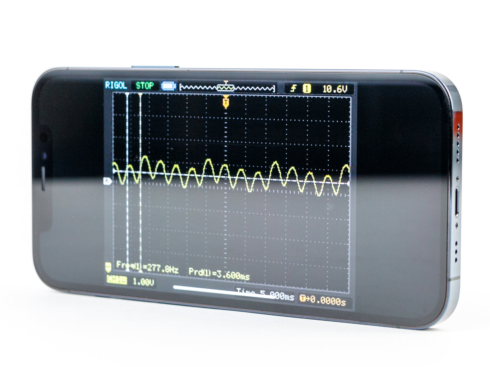

Notebookcheck has posted PWM measurements for the iPhone 12 Pro awaiting the full review (only in German so far):
It looks better than previous models, but they don't have any flicker percent or flicker index measurements as usual so it's hard to tell how much flicker there is.
Reactions: VadimVV
Very interesting article! Thank you for sharing the link!
Confirms previous data and user reviews - the new 12 is not as flicker-perfect as the 8 Plus, but significantly better than previous OLED models.
Translated via Google (Safari was giving an error when trying to translate):
“Over 22 percent of the time, the Super Retina XDR display falls into a 60 Hz mode, a method that is also used for DC dimming. The brightness range extends up to 150 cd / m², so that this spectrum is most likely to be used in closed rooms. In addition, the luminosity increases sharply and the amplitude curve is relatively irregular, since in this case, however, the ambient light should also be correspondingly high, provided that the control of the display brightness is left to the sensor, this should not strain the eyes too much either.
Apple does not talk about DC dimming itself, but uses a cleverly adapted control of the panel to keep the PWM load from the display as low as possible. However, we cannot completely rule out complaints.”
I still think there should be an option in Accessibility that reliably minimizes PWM, but I think iPhone 12 will be worth a try. Now, to decide on which model 🤔.
