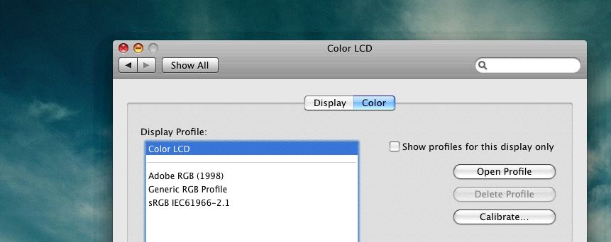

Here's what JUST happened when I logged in and out..
I am livid.
Whoa, I'm not getting any of that on my screen ^^^^^. I have noticed this on the windows i,e finder, system preferences though, its like a border around the window. Is it normal I can't see it on my 15" unibody.

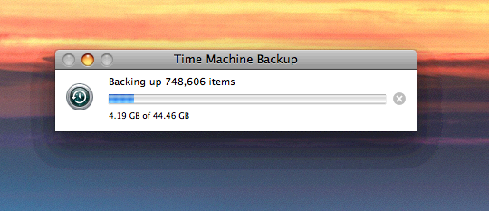

This is worrying, it's on everything ! Is there anyway I can turn it off, it's like a shadow.
EDIT: I'm using the GT higher performance graphics card, and there are like gradient lines on all the windows even on the top of safari ( the part with the address field )

Lol your quite funny.
I can change my settings to make that effect too :)
Lol, well it's like when you go in expose you get a shadow affect. I have just realized that I change colors from millions to thousands.
... Just changed it back and it's a lot better. Phew !
