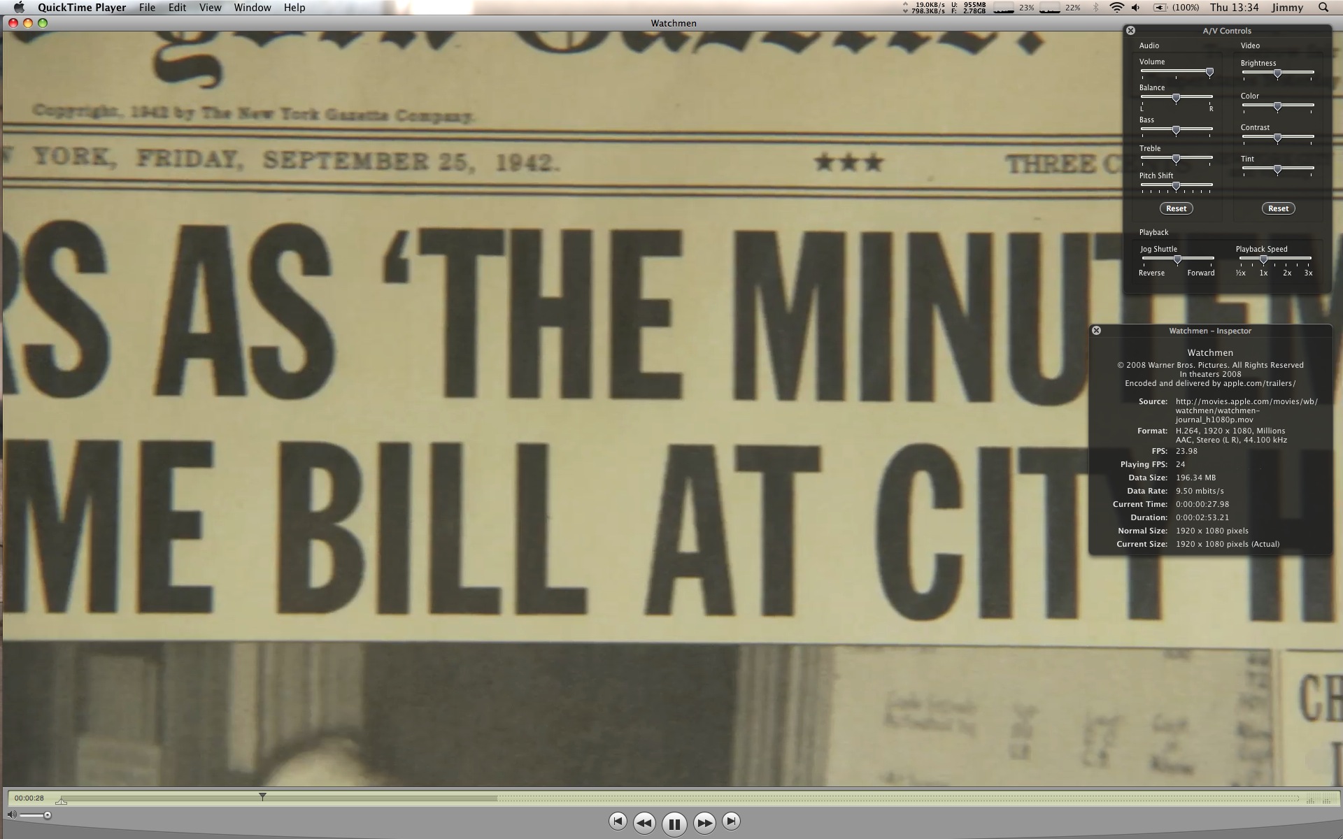

Here's a screenshot while playing in the 9600GT card. See how Quicktime states I'm running at the specified FPS in the corner. Don't have a screenshot in 9400M yet. In fact, I'm late for class.
CPU is also at a low 25% both cores.
