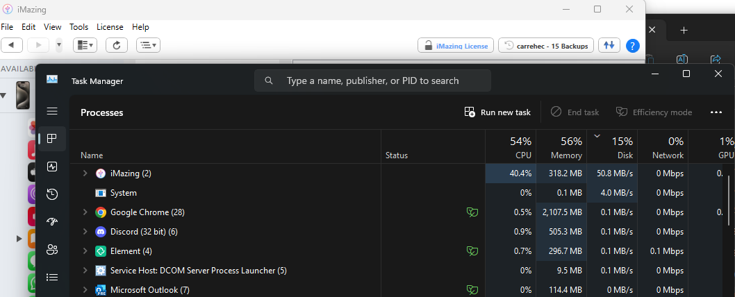

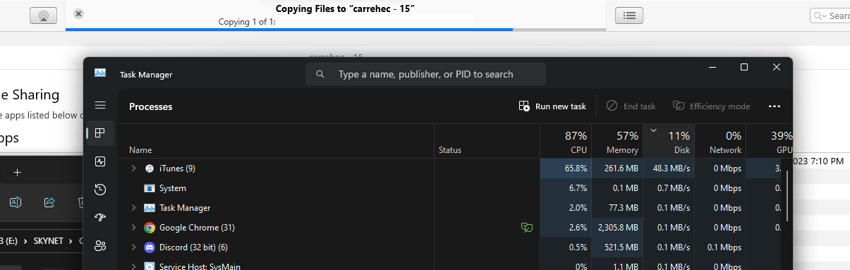

Update: I have done further testing. I transfered the same file to my iPhone using iTunes File Sharing and iMazing, and get similar speeds.
Same cable and port as mentioned in the OP.
Only a measly 50 MB/s. :(
What's more staggering is the amount of CPU resources used. There's so much overhead. The culprit seems to be 'MobileDeviceProcess' which I believe is an iTunes binary from who knows what year.

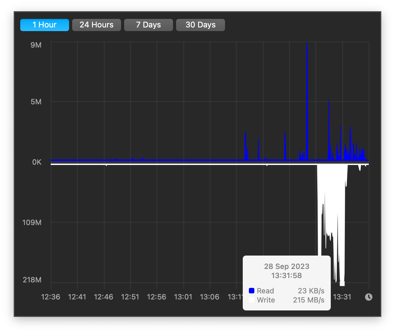

So I did a simple iPhone backup to computer, it fluctuates from 20MBps to 215MBps so round 160Mbps to 1.72Gbps, I have iPhone 15 Pro with an Apple Thunderbolt 3 cable, running MacOS Ventura 13.4 on a Macbook Pro 16 inch 2019.
edit: specify what computer I'm using
