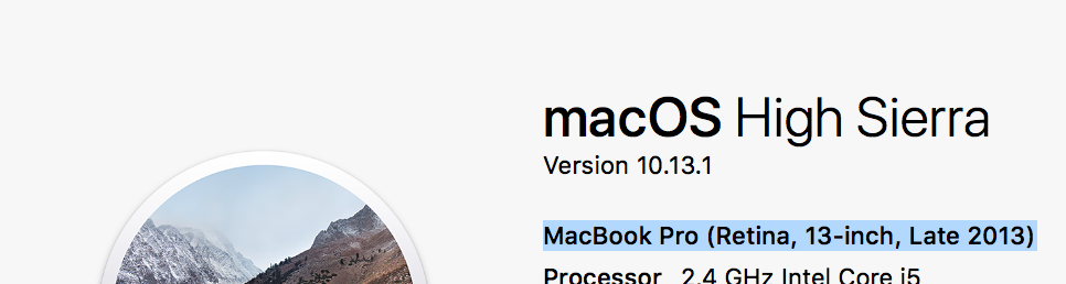

Hello this works for me. Not sure if you saw my post.
