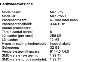

Hi,
My firmware version seems to be: 9144.0.7.4.0
Is this ok for a bootable nvme.m2 ssd card?

You Mac Pro currently have MP51.0089.B00, the last firmware update from High Sierra era and with no NVMe support at all.
Read the first post below to know what to do to upgrade to 144.0.0.0.0.

as @tsialex said, thats a Firmware without NVMe boot support,
keep that Firmware dump in a secure location, this can be a life saver if it is damaged.
