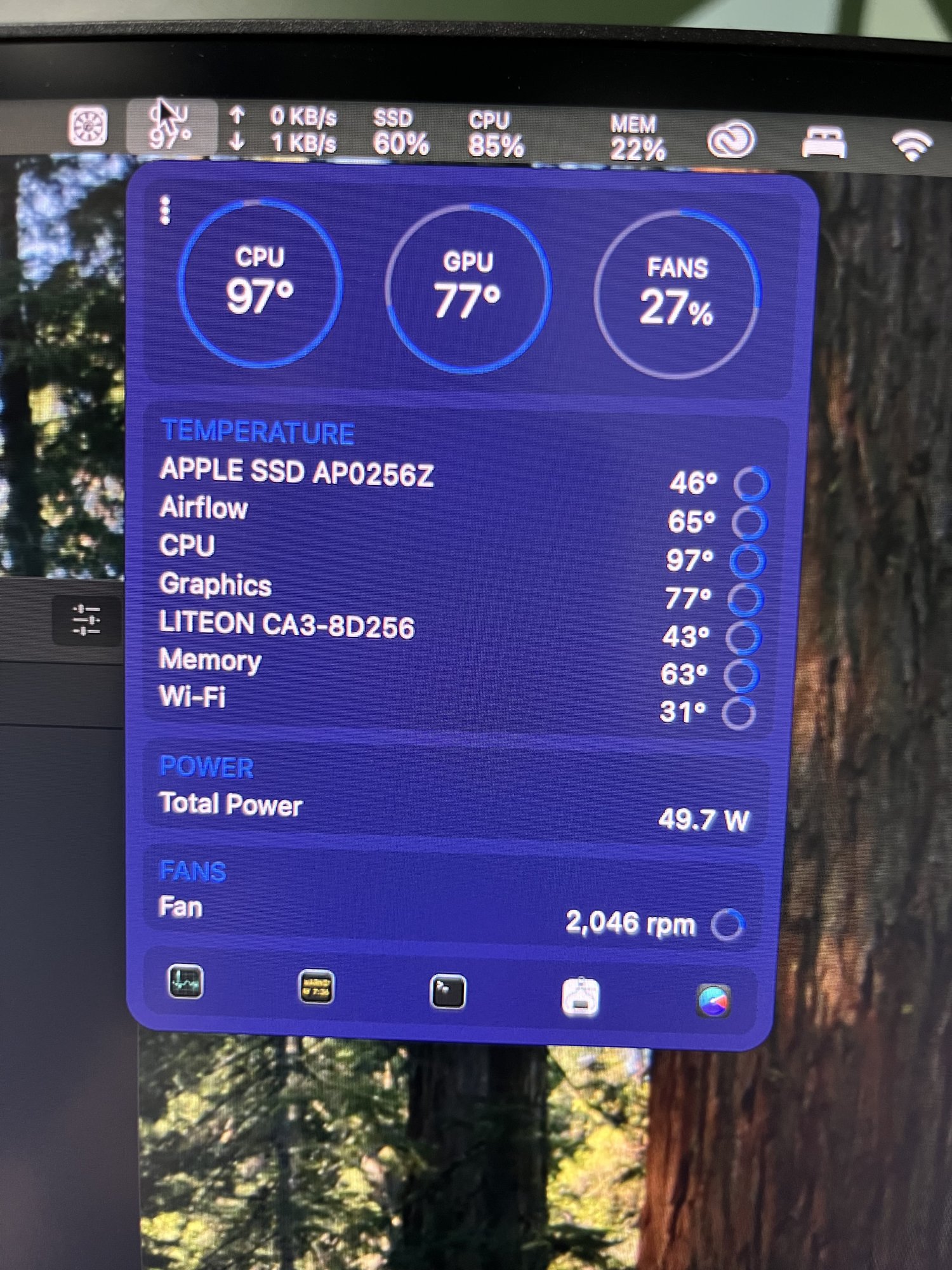

I got the base model M4 mini, when pushing it hard (gaming through Whisky/wine) it draws ~46W, the fans spin up to around 2500-3000RPM. 20cm away the Apple Watch 7 reads about 41dB, noise floor is 31-32dB. Ambient 25.4C. AVG CPU is ~89C, hottest CPU (performance core) 103C. At this level I'd call it noisy/obtrusive, you're probably gonna want to slap on headphones if you had to keep it at this level and work long term.
I'll call the machine quietly audible at 33dB (non obtrusive wooshing), drawing 32W, fan ~1450rpm. (I capped fps to 45, 4 P cores maxed and gpu at around 70-80%) This would be a pretty moderate load.
The machine is practically silent at anything below say 27W, fan
I let the machine idle and the fan reports 1000RPM. With my ear up against the machine you can still hear the fan hum (almost like quiet mains transformer humming) but when say moving my mouse around while watching a 4k60 YouTube video there's no sharp coil whine noise or anything, so it's very well behaved.
I've tried raising it so the intake/exhaust can breathe better, but the increase in noise level more than offsets any gain in cooling efficiency. Hope this helps.
