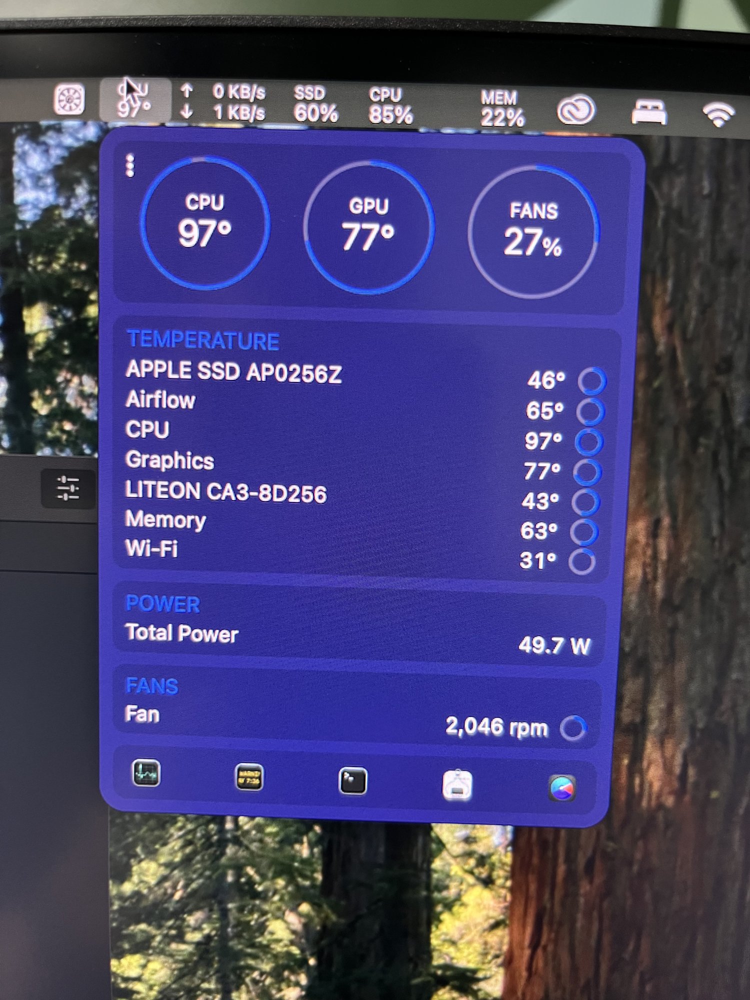

I am having the opposite issue M4 Mini base exporting video in compressor cannot hear the fan even at high temps.
