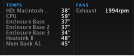

Ok, don't know if this helps to anyone but at least for me worked out.
I bought a MacBook Pro 13" one month ago. Since a couple of week it started the well know "heating issue".
this was the initial situation:

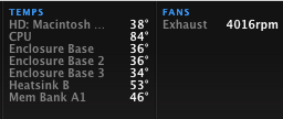

I check the Activiy Monitor and noticed that SyncServer was taking 18%- 19% of CPU usage. I thought it was not that high but compared with the other processes is very high (between 0 and 2.6% for Finder). Anyway, I decided to quit SyncServer and in one minute this was the result:
It have stayed like that so far. I have to mention that ical has to be closed otehrwise SyncServer will turn again on.
Now, I don't really know whether I did bad in quitting SyncServer or not. If it serves for syncing devises or applications taht run with ical I think I can live without them but with a melted Mac...
Please let me know whether this helps to someone and what you know about the SyncServer...

Yup, this is one of the first things I did on my MBP. Voiding warranty or not, I think it was well worth it...running a solid 10 degrees cooler at load than it was out of the box. Not a single heat related crash yet.
