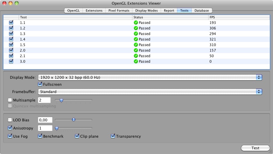

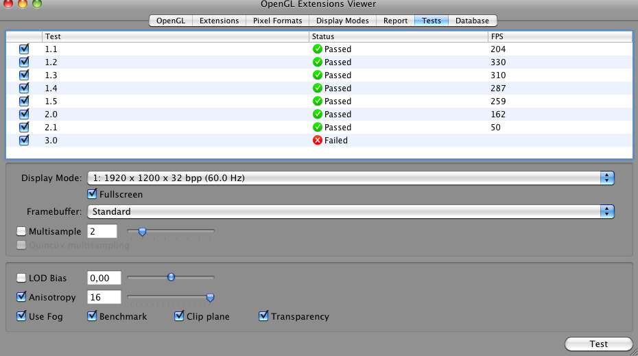

Curiousity got the better of me, and I decided to try flashing my Sapphire Vapor-X 5870 with the same rom supplied to macroysan by Netkas/Rominator in this thread. My PN: 288-1E140-100SA (as opposed to macroysan's 200SA)
aaaaaaaaand....
SUCCESS!
Unlike Macroysan, I have the latest Snow Leopard Graphics Update kexts installed... so interesting to see the increase in framerate and the fail of the OpenGL 3.0 tests... fascinating.
Strange though... I get no detected sound output devices upon restart from Windows to Mac OS... but when I restart again into Mac OS the 2nd time... sound works just fine. Wonder whats going on there..?

Failing OpenGL 3.0 is really not that fascinating considering the operating system doesn't fully support it yet :)
Yeah - not fascinating that 3.0 failed - just fascinating that it "passed" with 0 fps on Macroysan's setup (w/out the graphics update drivers), but failed on mine (with them). And mostly just the difference between the framerates.

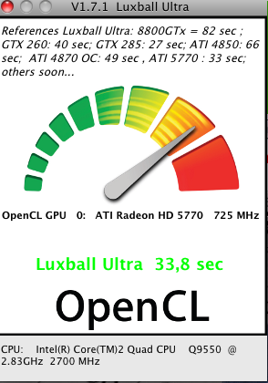

Hi Tesseract !
Congrats to you. If you would like to compare with my OpenGL Test then you have to sett the same settings that i did!
Take a look at Post 124
I use 1920x1200.
used your settings ..pushed even ansisotropy to the highest level 16
Your 5870 :
http://att.macrumors.com/attachment.php?attachmentid=246510&stc=1&d=1281961947
my 5770:
http://att.macrumors.com/attachment.php?attachmentid=246511&stc=1&d=1281961968
http://att.macrumors.com/attachment.php?attachmentid=246513&stc=1&d=1281962887
5770 looks better --Tessaracts 5870 vapor-x looks best
we have to see more from the 5870 with new drivers ....yes.. where the new 5xxx cards really shine... thats opencl
twice as fast as a HD 4850..and thats with an opencl driver bug detecting the card not with 850Mhz ..only with 725 Mhz (its very close to a GTX 285 !)
good decision from Apple to look into the red corner -the 5770 is dead silent - fast - draws almost no electricity - like it.
