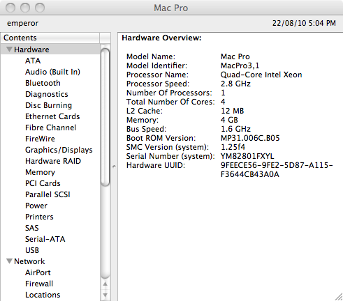

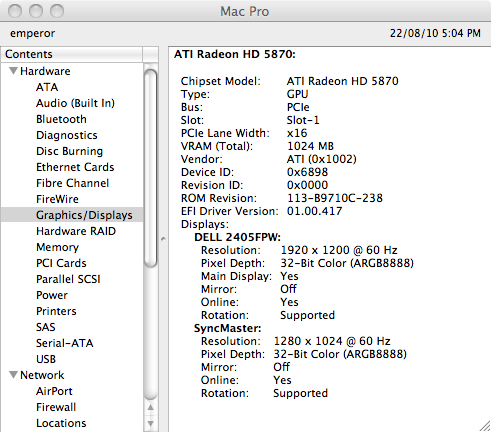

My 4890 doesnt support sleep, picture crashes after returning from sleep.
Thinking of replacing it with a 5770.
Regards
Claus

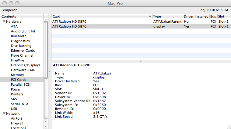

Click on PCI cards. This will tell if you have PCI-Express 1.1 or 2.0 after flashing.
Seems to be 1.1. GPU-Z in windows seemed to indicate this too.
To be honest, I'm not that fussed... this machine's main use is development, and TF2 runs at full res with maxed out settings at 60fps with vsync without problems.
