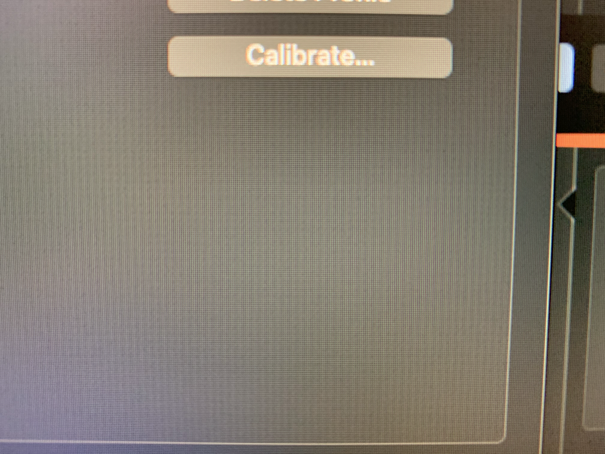

I recently purchased an Intel Mac Mini (running 10.15.7), but after seeing all the positive reviews of the M1 quickly decided to go with the M1 instead. I just received my M1 (running 11.1) a couple days ago and I have noticed that there are very noticeable flickering vertical lines all over the screen, particularly in areas with transparency and darker backgrounds. This picture shows the lines, and in real time the darker and lighter lines alternate, making the screen appear to have a vertical texture in places.
I've set up the Intel Mini with an identical monitor and identical HDMI cable, and the flickering either doesn't happen or is too fast to be perceptible, making me think this might be a refresh rate issue. However, both machines are set to the same display settings (1080p, 60Hz).
It's not clear to me whether this is a hardware issue with the M1 Mini or a software issue with Big Sur. Is anyone else having a similar experience? Really loving the M1, but the flickering is starting to get really bothersome while using certain applications that involve large spaces of what should be a matte color background.

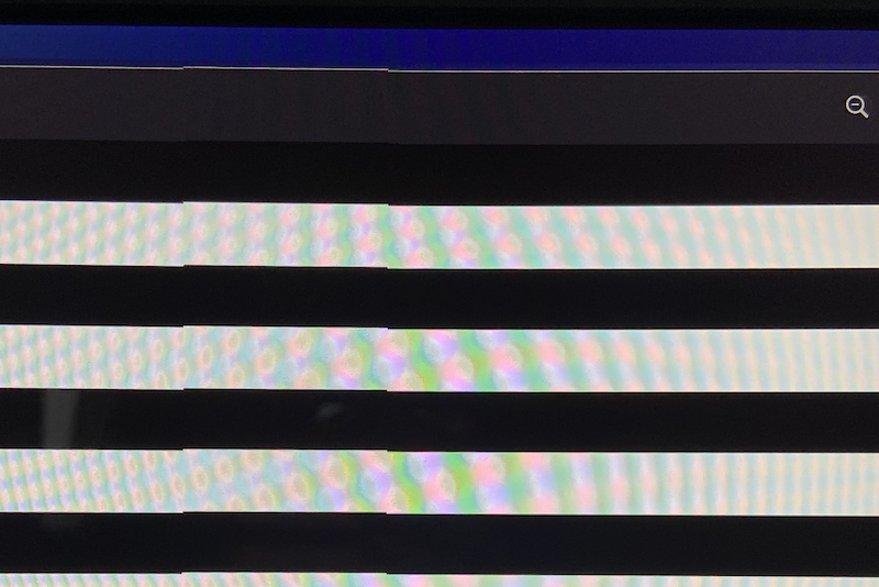

My issue is an odd one, a 5cm wide rectangle section of the screen running from top to bottom has shifted up a few pixels. It seems to happen after a few hours, and I'm not sure if it's after being on standby or not yet.
A reboot doesn't resolve, but a shutdown does.
Anybody seen this before?

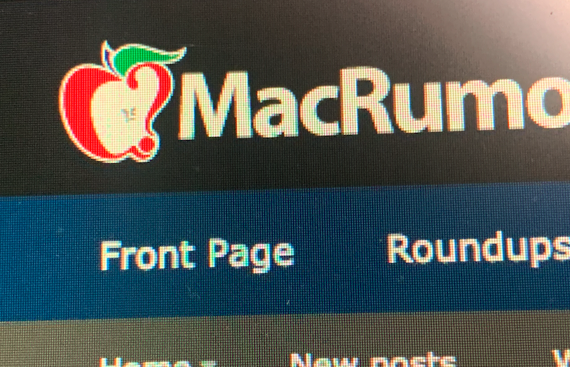

exactly the same issue here with a BENQ EL2870U , M1 Mac mini 8GB , 256GB Here is what I and apple support have tried so far:
it happens the most on viewing this image: https://unsplash.com/photos/kp7ENPlp8no I get vertical lines and shimmering as I scroll down
1) 3x Different HDMI cables
2) Safe mode
3) Recovery mode with safari
4) Switch Res X different refresh modes 30hz, 50hz all show the same issue only less.
Also tried another Ben Q monitor of the same model and the same thing happens.

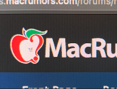

I'm seeing pretty much the same thing as you show in your photo on an external monitor connected to my M1 MacBook Pro running 11.2.1 (the monitor is a 23"HP Pavilion (1920x1080) connected via HDMI with Apple's AV Digital Multiport adapter). Like you, it is most noticeable on darker backgrounds.
I was wondering if you have determined the cause and/or fix? Interestingly, when I connect my M1 Mac to my Samsung TV using the same adapter and HDMI cable I do not notice this issue. Both my monitor and the TV have the same resolution. Also, when I connect an Intel Mac to my monitor I do not see this issue.
