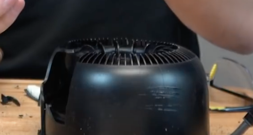

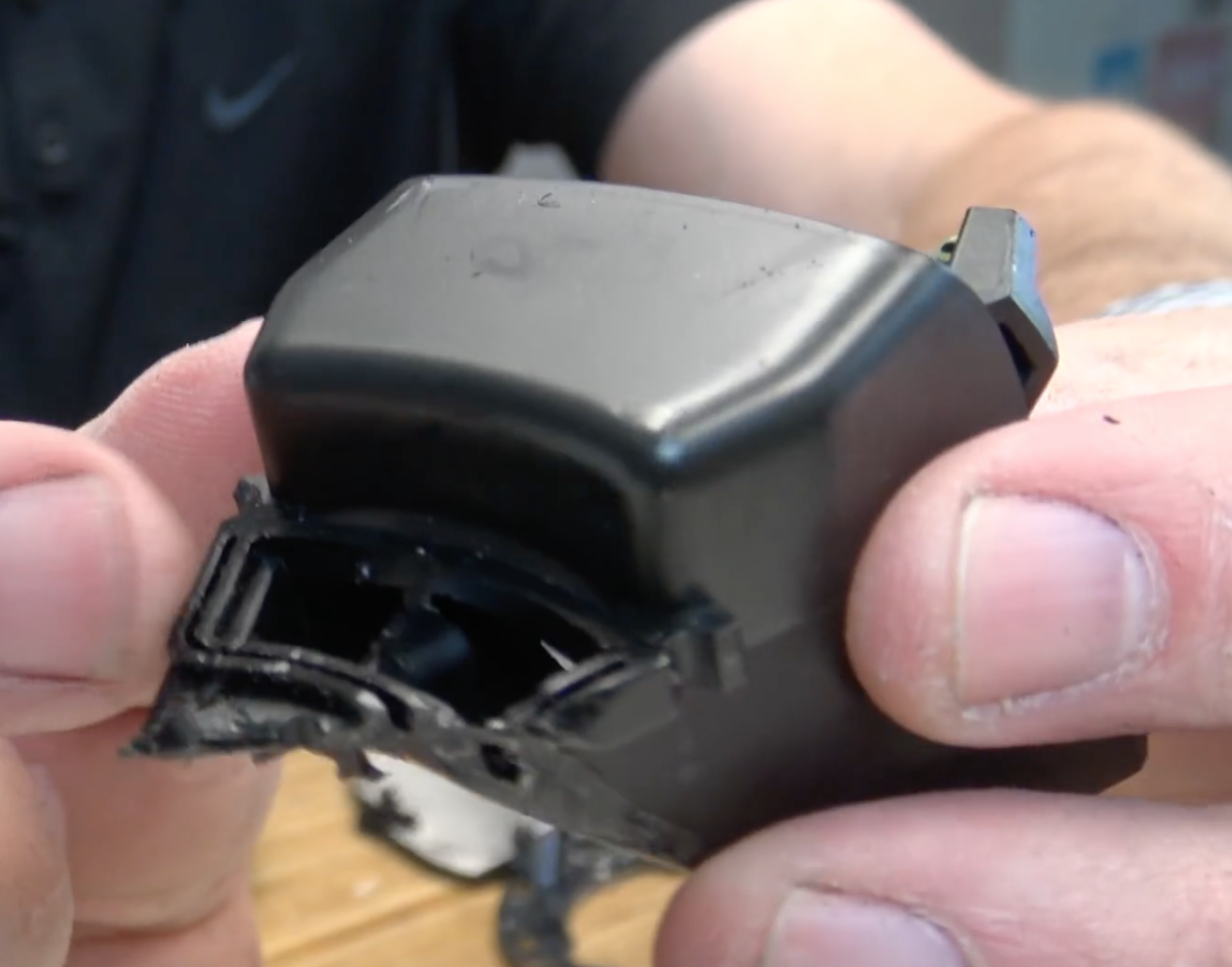

This guy bashes his way in with a dremel and an axe .Strange, tweeters are these little plastic pods. Are the tweeters venting out the bottom ports?
Nope - the vented but is at the top, presumably for the air from the woofer. It's really weird, the tweeters really are tripped in the bottom and seem to fire or rebound upwards out of the top of the device too.
The photo above that shows those slats/ports is the very bottom of the HP with the rubber boot removed. Not sure if the tweeters are open to that and firing straight down. If not then they are firing at a plastic wall. LOL. That would be weird. But each tweeter is enclosed in its own plastic pod inside the larger mother plastic pod.
I don't think the tweeters are porting out the bottom, the bottom port is the bass port. The tweeters are just completely trapped. So bizaro. I think Apple designed themselves into a corner.
EDIT: OK, here is the rear of the tweeter pod... the rear of it is ported and facing down towards the bottom ports. LOL. This photo shows it held upside-down. (actually, I can't quite tell if the bottom ports is adjacent to tweeter opening or not). Bottom port might only handle bass. Why are the tweeters so trapped like this? I wish someone would cut an opening for them. : )
That's definitely the top mate, where the Siri screen is. The bottom where the tweeters are is sealed - and then they're sealed in plastic cases too...it's really weird.
Edit, ignore that, there are slats on the top and bottom - so yeah I guess the tweeters are firing out of the bottom at least. Out of their plastic houses.
  • Haha
Reactions: confess_jason
The video showed each individual tweeter housing had a hole on the bottom, aimed down toward the bottom vents. So it looks like tweeters go down and bounce off the table surface, while the woofer goes up into the air. I really wonder where the mics are positioned, though.
If you look at the side of the plastic cylinder, you can see little "vents" where the mics must be. The vents for the tweeter pods are at the back of the tweeter and at right angle to rear of tweeter.
