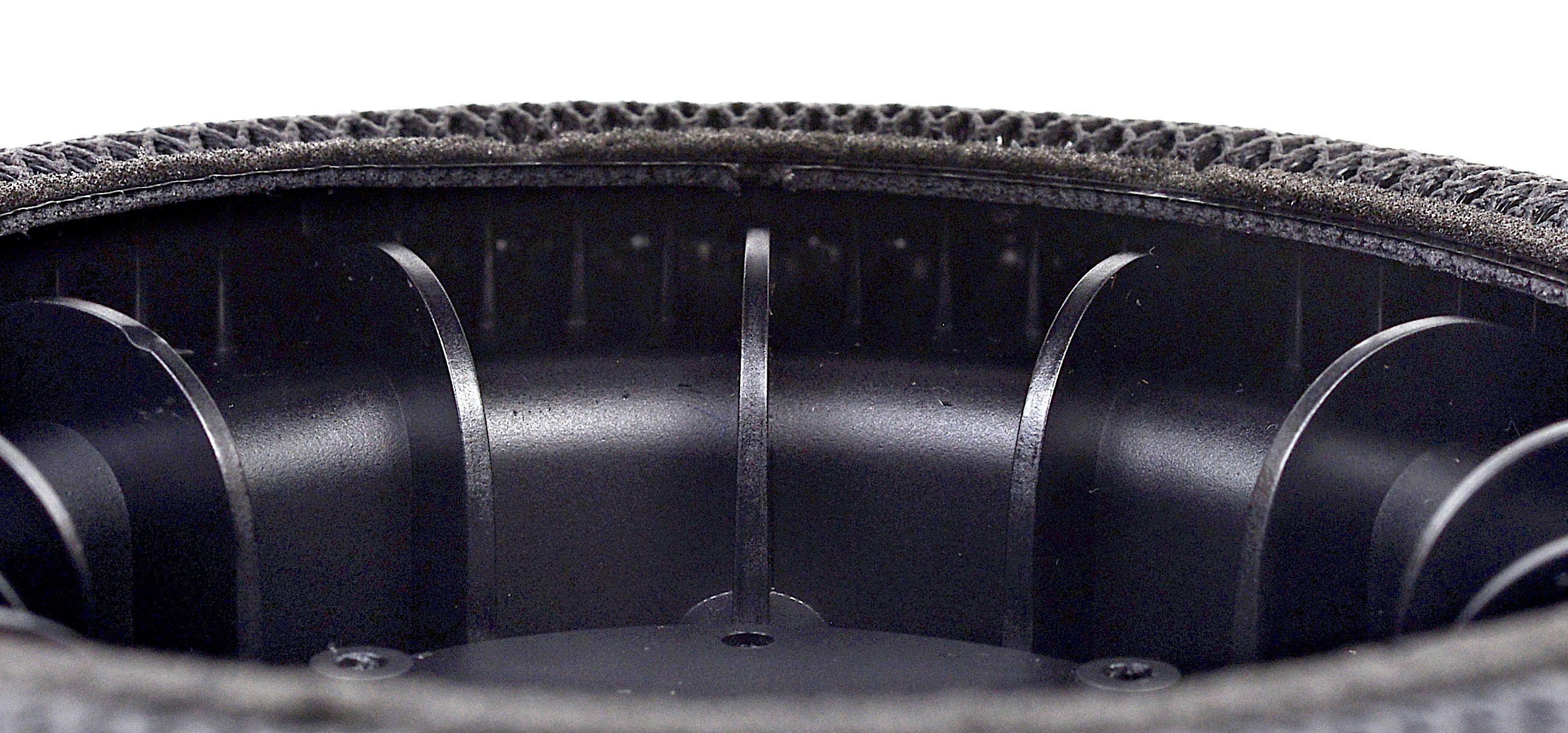

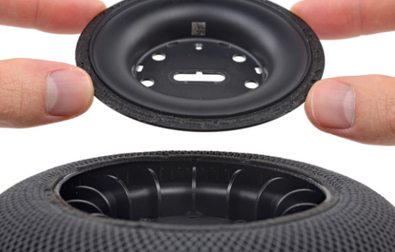

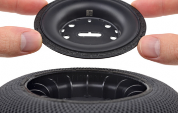

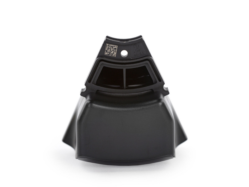

I think you guys are over complicating matters. The pictures can make it look deceiving but the wheel wasnt reinvented here.
This is a view of the top of the HomePod looking down in after everything else has been removed....
The tweeters horns (horned tweeters) are extended via the case on the bottom. The ports (2 each) for each tweeter are sealed with the bottom cap to isolate them from either other.
They are then firing through the ports which are directed out of the side intentionally across or ever so slightly above the surface it sits on. Here is a closer look where it goes into the mesh.
But they are very much directional with some audiophiles (not myself of course) claiming to be able to hear the frequency dips moving between them at range.
I get it, the sound may not be to everyones liking but most of the testing I see (sorry I skimmed the thread) are reporting a flat response.
But I think when we are saying EQ here we are just looking for EQ presets that work with Apples DSP. How would you EQ for a device that is omnidirectional, different EQ for each tweeter based on directional room acoustics and not intended for a stationary listener?
So I personally doubt Apple will ever have an actually EQ in the HomePod. I would actually be surprised if they added much more than a "reduce bass" toggle if anything at all.
Personally if the HomePod doesn't sound right to you I would experiment with room placement keeping in mind the middle of the room may not be best either. If the bass is too heavy, pick it up and put it down and then crank something with very heavy bass to force it to calibrate for it. If nothing works I would high recommend getting a product that works better for you and not waiting for Apple to add features.

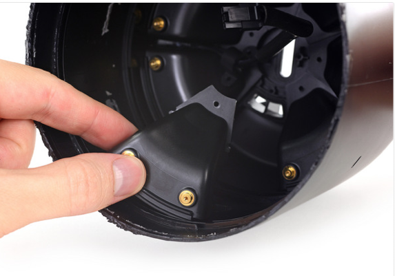

Gotcha, now I see what they’re doing. The tweeters are essentially pointing into the device, and the little horn directs the sound downwards towards the vents.
