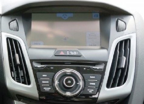

Here is a screenshot from my soon to be Ford Focus '12 model:

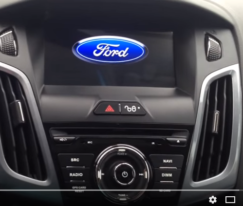

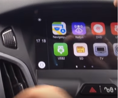

Navimex Multimedya screenshot Ford Focus 2012-2014 from YouTube video so does this mean my system does support Apple CarPlay or do you need additional software installation or hardware changes to get this? Here is also a link to their page for this called "Navimex Ford Focus Nav-9912''. Is this a rip-off of CarPlay or is this actually CarPlay?
The Ford / Sony? car system they are using (see screenshot below again from that video) looks exactly the same as the system in my Focus '12 one.
Can you remote start the engine with your phone? If you can,it supports CarPlay. Just that it looks similar to the phone screen does not mean it support CarPlay.
Ford did not start supporting CarPlay until it switched to using Sync 3 starting in most 2016 models. So the answer is no, you have Sync 2. In order to use the Navimex system you must buy and swap out your infotainment system. Hardware, programing and install would probably cost between $1000 to $2000 to upgrade.

The info you are linking to is NOT for a CarPlay/Android Auto setup. It is for cell phone mirroring. It will just display what is on your cell Phone screen exactly the same on the car system.
