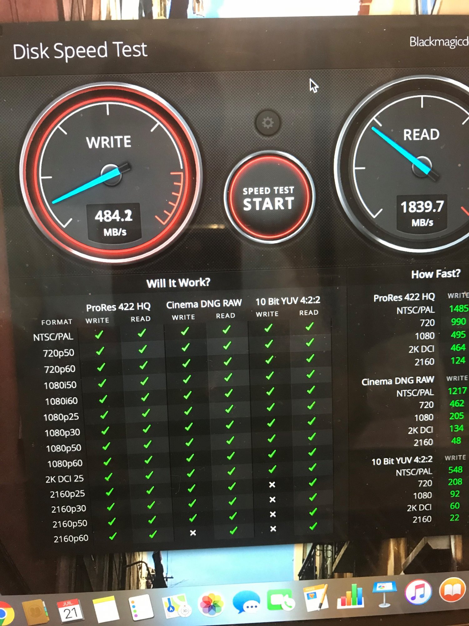

Hi,
I did install with the 2240 sabrent 1To and the adaptator. Reinstall macosx and copy from time machine without no issue.
The ssd is now always booting, no more issue, with and without charging.
My only concern is the Write speed ( 480Mb/s) seems very low ? Any idea ?

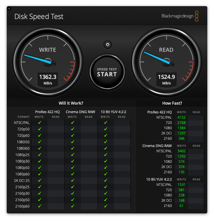

Although the reading speed of the sabrent is lower, I have not found any speed differences compared to the old ssd and I want to clarify that I use a lot xcode which uses a lot of system resources but works exactly as before.
