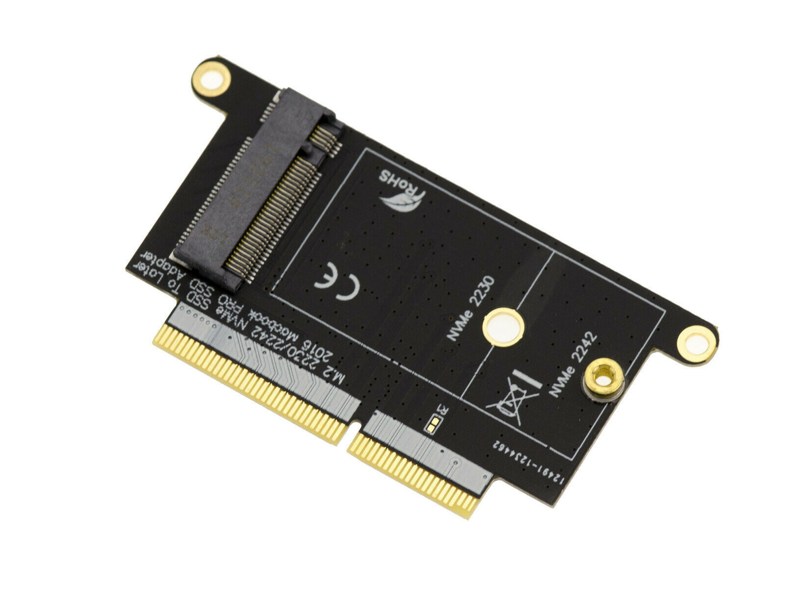

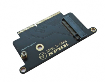

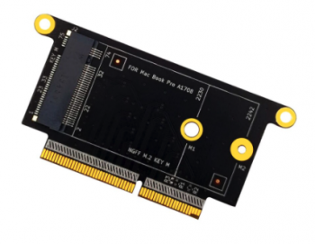

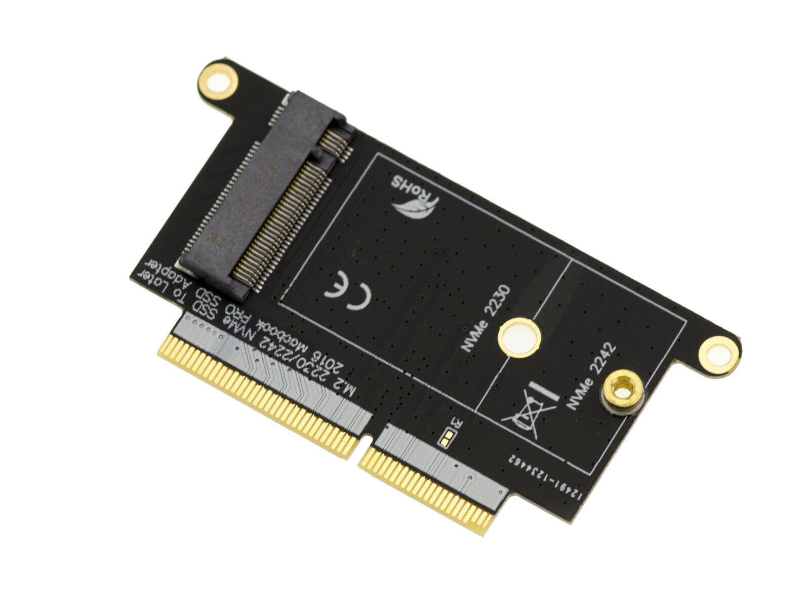

I'm thinking of upgrade to a Sabrent Rocket 1Tb. My question is with the adapter, do you know the difference between these two adapters?
A1708 NVMe M.2 NGFF SSD 2016 a 2017 Macbook
NFHK N-1708
I'm not sure what the difference is between them but i had problems with the NGFF adapter. When i installed it, my ssd was not showing up in disk utility. When i ordered and installed the NFHK adapter i did NOT have any problems with it. I would recommend the NFHK adapter.
Received this morning this NGFF adapter and had problems too.
Finally I have returned this adapter
Thank you very much, Ivanavila, for your answer. I will investigate what the difference is but it is clear that the NGFF adapter does not work properly. It's strange because the NGFF adapter is more expensive.
I have the NGFF from Sintech and it's working perfectly

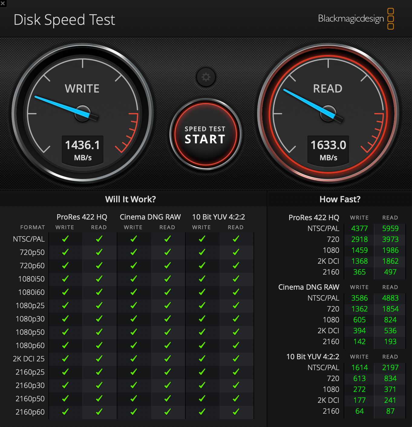

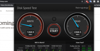

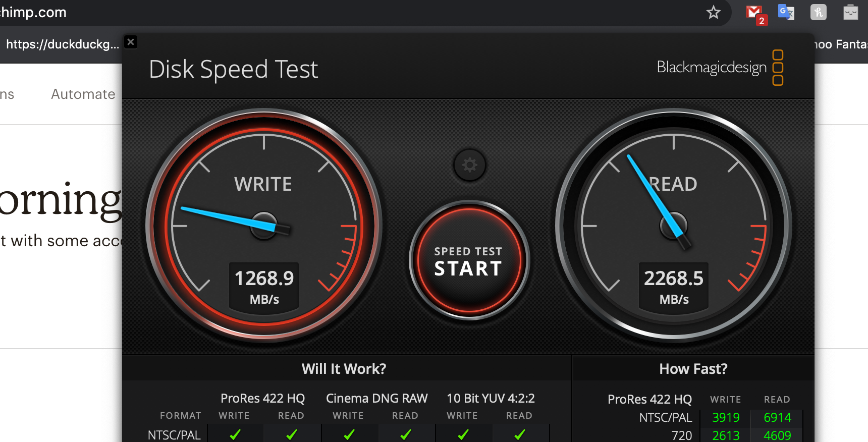

Hey guys, just finished successfully installing the Sabrent 1TB SSD and the NFHK N-1708 adaptor. Installation was pretty easy and everything seems to be running smoothly. Posted my before and after results with Black Magic, unfortunately I cropped the before a bit so you can't see the whole thing but still should give you a good idea.

Update to my previous post, I am having the same hibernation and battery drain issues reported by some of the other users, and also the missing disk icon if I try to cold boot with the powercable plugged in.
I've tried enabling trim by using the command:
sudo trimforce enable
And also tried using:
sudo pmset -b sleep 10 disksleep 5 hibernatemode 25 autopoweroff 0 standbydelaylow 300 standbydelayhigh 300
and also still not fixing the hibernation issues. When I close my screen and open it again it just loads right to my desktop. Any help would be appreciated. Right now, I'm not sure it's worth the extra 1TB to have the battery drain issue since it won't hibernate.
