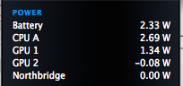

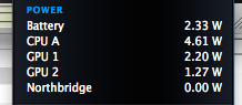

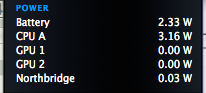

First i'd like to thanks bitninja and ah- for helping us to bypass Apple's limitation.
I have noticed with iStat Menus that both GPUs are powered when you use gfxCardStatus 1.6 to force the system to switch back to Intel HD running on a 15" i7.
See the 3 attached screenshots (GPU1 = 330M, GPU2 = Intel HD).
1st = Forced to switch back to Intel HD, both GPU are powered.
2nd = Intel HD automatically activated, it seems no GPUs are powered???.
3nd =330M automatically activated, seems OK.
I'm not sure if we can really rely on iStat Menus for these results.
Is there any other way to check the GPUs state?

No problem! That's one of the things I suspected...I'm not 100% sure the implementation currently in v1.6 completely disables the 330M. Can you confirm that the 330M isn't powered when on the Intel GPU without manually switching to it at all?
As the second screenshot in my previous post showed it, iStat Menus shows that both GPUs are not powered. It seems that it doesn't fully support the new i5/i7 models yet.

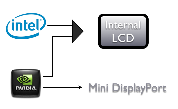

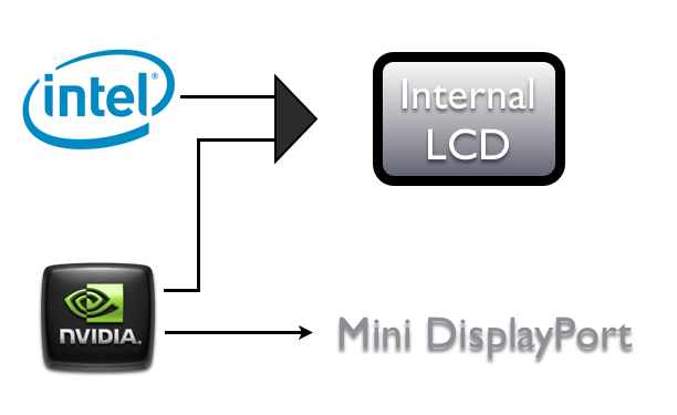

I've also noticed the Intel HD has only one video output directly connected to the internal LCD. It doesn't really matter because if you want to connect your Macbook Pro i5/i7 to an external display, you will certainly not use it on battery.
