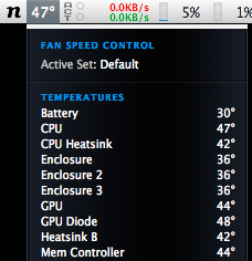

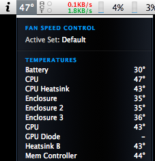

i just use temperature monitor to see which one is in use. if the 330 isn't in use, it doesn't shoe me a temperature for it. is this actually working? or have i fooled myself into thinking that.
also, very rarely does it go off, my 330 is running right now and all i have open is safari and iphoto. closing iphoto does nothing 🙁. i think in the month or so i've had my macbook, i've seen the 330 shut down maybe 5 times.
I have recently noticed that if you force it to Intel HD, the GPU Diode indicator in iStat menus turns to - no matter there is a dependency or not in gfxCardStatus. Looks like the 330M is really turned off.

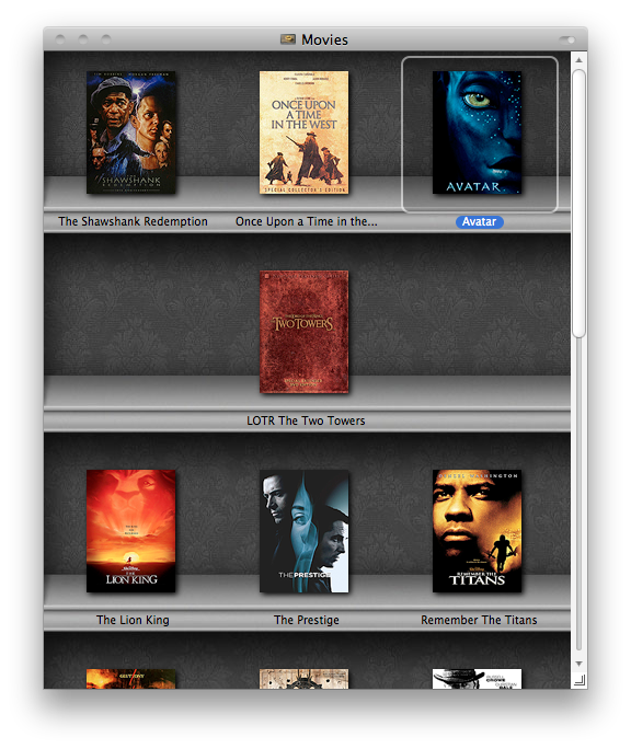

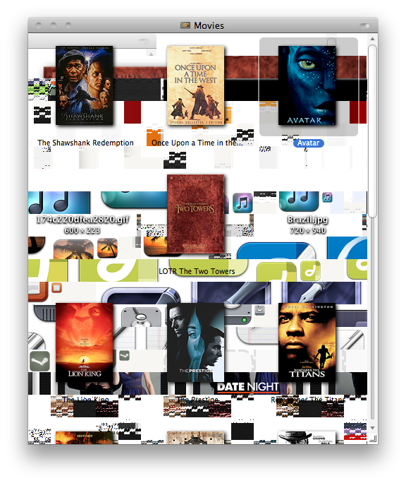

So after the recent update to 10.6.4 I've noticed some odd things. I use some customizable options in Finder, such as using a Background picture to organize my Movies nicely and normally it should look like this:
content
But now it looks like this:
content
until the nvidia chip gets activated. Is there any way to set the chip to activate when the folder opens?

I suggest restarting Finder, and if that doesn't work try rebooting. This is a very odd problem.
I don't think that there's a way that you can make it switch to the NVIDIA chip when you open a certain folder.
(pardon my cluttered menubar)
I believe 10.6.4 added a limit to the size of the image that can be used by the intel chip (for whatever reason, I can't understand why), b/c smaller images work fine, but the one I'm using is almost a MB in size and it worked perfectly before 10.6.3, but now it doesn't unless the nvidia chip is activated.
But restarting finder/computer does nothing. If you don't mind can you link me or send me that background you are using?
