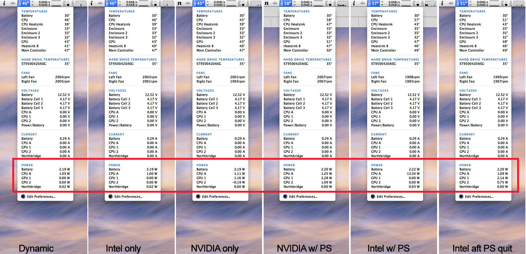

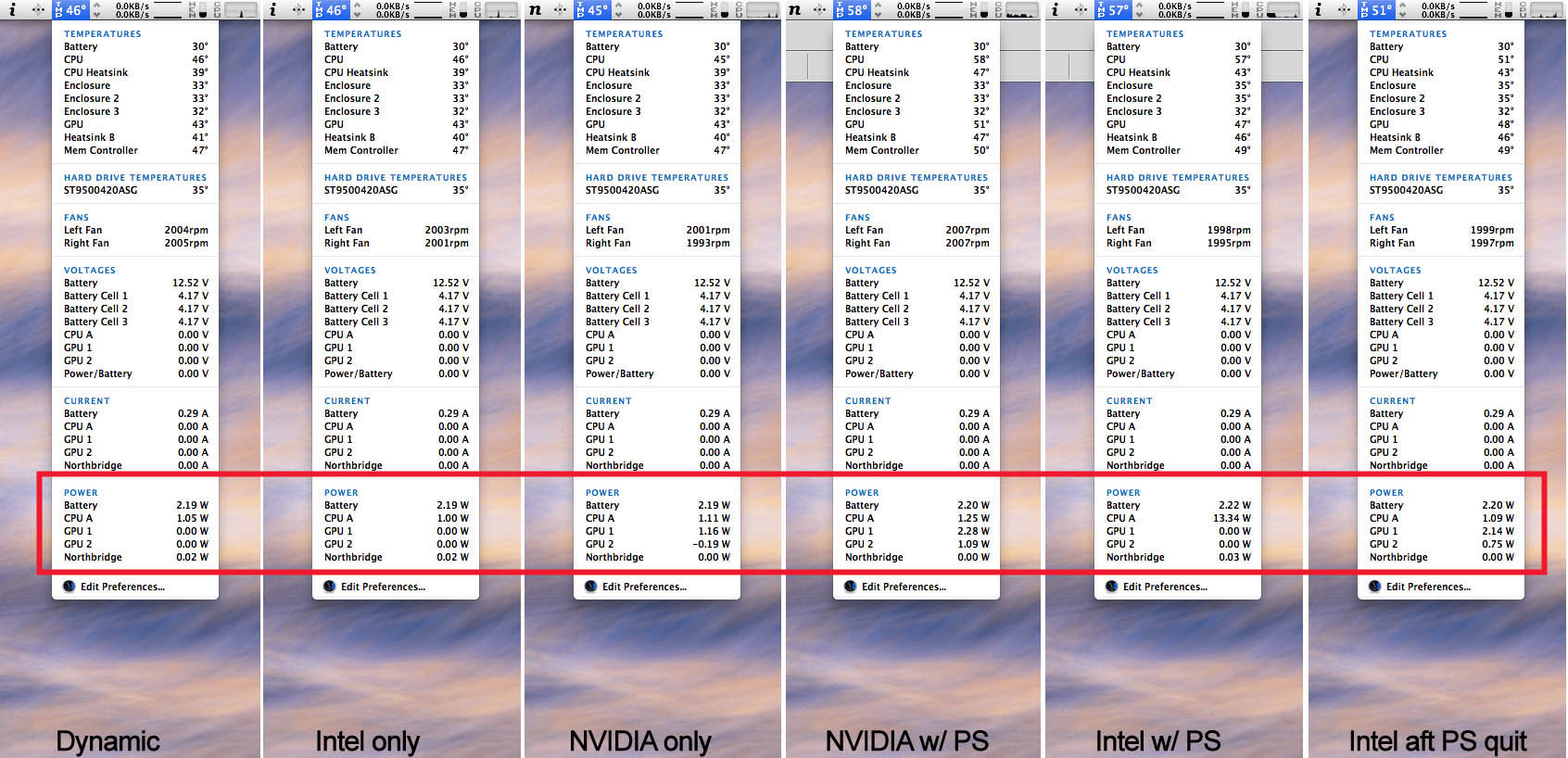

I tried version 1.7.5 and here is what i find. Again the GPU locks to either intel or nvidia but after quiting PS/VLC etc in intel only mode it somehow runs to mama and activates nvidia (however, this time Growl won't report it), but it can be seen in istat. To illustrate the situation better I have attached annotated screenshots during the events or find it here http://imgur.com/WE3dY.jpg.
Should I be doing something in sys prefs or elsewhere that I am not and hence ending up with this issue?

Well that's annoying...darn. What it does now is it looks for a situation like that. Every time it switches it says, "okay, are we supposed to be on Intel Only mode?" If so, and it finds that the 330M is active, it attempts to force a switch back. It's almost always successful (unless you have an external monitor connected)...but it's apparently still subject to the issue where the 330M stays on. We need to get in touch with ah again to see if he can help us in regard to the switching code - my understanding of exactly how it does what it does is somewhat limited. Driver programming was never really my thing, but I've got a lot of years ahead of me. 🙂
