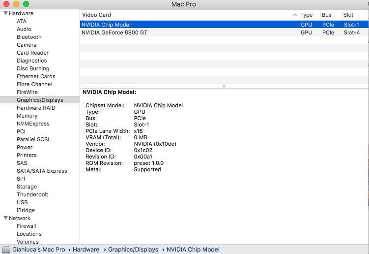

I've just installed a GTX1060 3gb... and it doesn't work... what can i do ? 🙁 Driver installed and updated... i'm running 10.12.5
Did you select Nvidia web driver before reboot? Only installed is not enough.
Yes... nvidia web driver was already selected, i have also a nVidia 8800GT for boot now. I have also reboot 🙁
Sierra show only nVidia Chip...and nothing more
