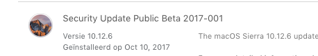

Like an idiot, I did today's update and my system booted back into Windows for some reason and I'm having a real nightmare trying to get back into MacOS. Does anybody know if today's updated has knackered nVidia's driver support?

I think Nvidia usually only provide new driver for the latest OS, isn't it? Now they moved to HS, which may means they won't release any new driver for Sierra anymore.
Not sure about that. 10.11.6 got an incremental update a couple of months ago which changed its build number. Nvidia provided the new driver the following day.
Having said that, I don't see the security update you're talking about - I'm on 10.12.6 myself.
No they don't, they supply drivers for the latest OS releases. But, if you look, the security update listed above is a Beta. Nvidia doesn't supply drivers for beta releases.
