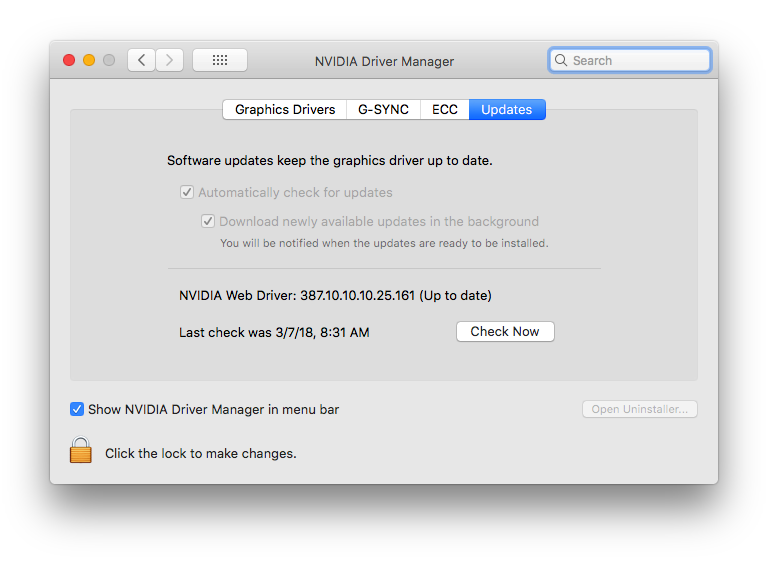

Nvidia web driver V161 is available now, not sure what’s changed, hopefully some bug fixed.
Anyway, it’s safe for 10.13.3 (17D102). Just direct installation (update), no specific procedure for non-flashed Pascal GPU.
P.S. My SIP is enabled.
