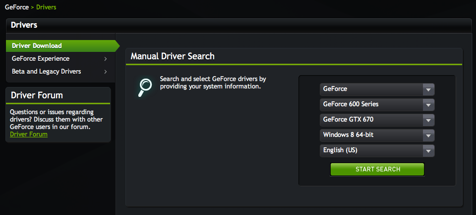

I know there are several references to the NVidea drivers, but there are some 500 posts, and amongst these several references to several versions of drivers. I just wanted to check if there were newer drivers...
No problem bob!😉
This is the place to be! http://www.geforce.com/drivers select the buttons for your needs:
Done!
Goodluck mate!
All is working now - THANKS TO ALL FOR HELP AND GUIDANCE!
