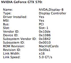

^^^^My MP3,1 with a Gigabyte GTX570 with MacVidCards EFI supports PCIe ver. 2.0 speeds under OS 10.8.3
