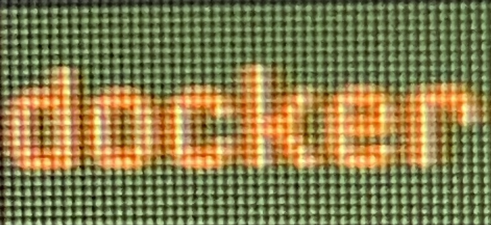

I've tried hooking up my 38WN95C-W to my new Macbook pro 14", but I can't seem to get a clear picture. I've tried several different solutions as they've been offered for various ultrawides but I'm kind of at a loss at this point.
Next to the macbook I also have an iMac which drives the monitor just fine. I've attached an example below to illustrate the point
Monitor using the 2019 iMac 27"
Monitor using the new Macbook pro 14" M1 Pro
It's not super noticeable, but it's really irking me that it's just slightly blurry and makes coding an absolute headache, which is the whole reason I bought this thing.

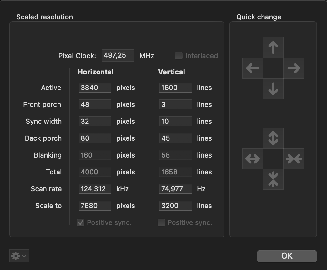

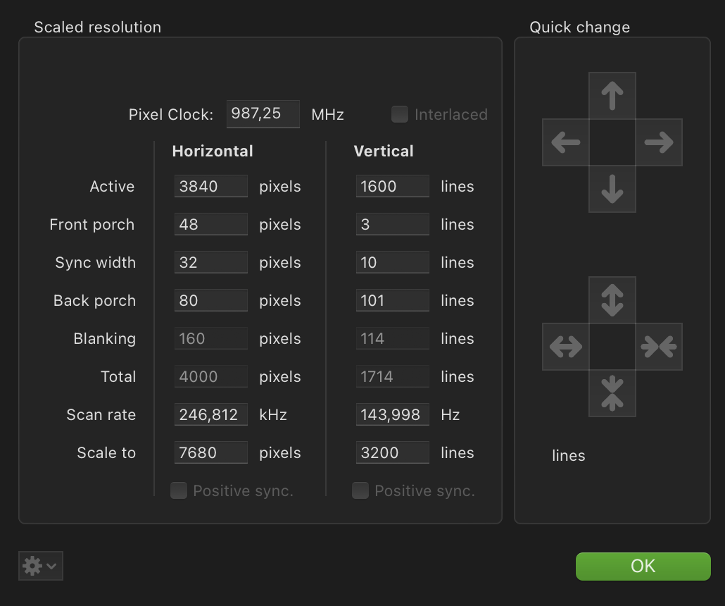

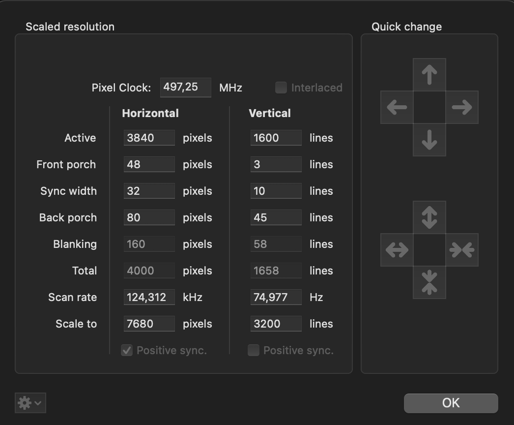

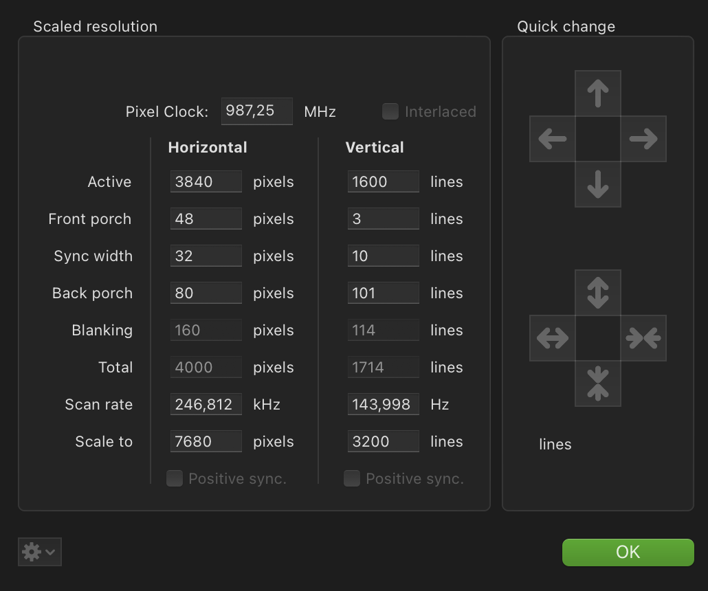

Selected resolution 3840x1600 (same as on the iMac when I check "scaled")
HDR is disabled, not even an option in the mac os selection.
These are the values from SwitchResX
M1
iMac
When I set the refresh rate on the M1 to also 75hz the values are the same
M1
iMac
This is the output of the script:
disp0: -> 3024x1964@120.000Hz 259.201kHz 804.56MHz h(8 32 40 +) v(102 8 86 +) (preferred) 3024x1964@60.000Hz 259.201kHz 804.56MHz h(8 32 40 +) v(102 8 86 +) (promoted) 3024x1964@48.000Hz 259.201kHz 804.56MHz h(8 32 40 +) v(102 8 86 +) (promoted) 3024x1964@59.940Hz 258.941kHz 803.75MHz h(8 32 40 +) v(102 8 86 +) (promoted) 3024x1964@47.952Hz 258.941kHz 803.75MHz h(8 32 40 +) v(102 8 86 +) (promoted) 3024x1964@50.000Hz 259.200kHz 804.56MHz h(8 32 40 +) v(534 8 86 +) (promoted) dispext0: ... removed for brevity 3840x1600@59.994Hz 98.750kHz 395.00MHz h(48 32 80 +) v(3 10 33 -) (promoted) 3840x1600@119.982Hz 203.250kHz 813.00MHz h(48 32 80 +) v(3 10 81 -) (preferred) -> 3840x1600@143.998Hz 246.812kHz 987.25MHz h(48 32 80 +) v(3 10 101 -) (promoted)
You are using a 7680x3200 scaled mode on the iMac and M1.
This means the GPU in the iMac and M1 need to scale the image down to 3840x1600. They may be using slightly different scaling algorithms.
You should try some test patterns with vertical and horizontal lines and checkerboard patterns. See how they are scaled when rendered at 100% (one pixel per line). Use the zoom feature of Accessibility preferences panel to verify that the test pattern is being rendered with one pixel per line (disable "Smooth Images" so that each zoomed pixel is a single discrete color). A series of single pixel wide black and white lines should output as gray when scaled down from 7680x3200 to 3840x3200. See if there is a difference in quality in this scaled down output between the iMac and M1.
Then, use a 3840x1600 non-scaled mode on the iMac and M1. They should appear identical since the GPUs are not doing extra scaling. There will be less blur since text is not being scaled down.
M1 and Intel scaling algorithms definitely differ, I noticed it as well when I switched. M1 seems to apply some kind of extra sharpening effect on scaled output which might be annoying to some and more pronounced on some color combinations and creates a mild halo around contrasting items (the effect is most noticeable when you invert the screen for example in Accessibility). I am not sure this is the same thing @tomre refers to.
