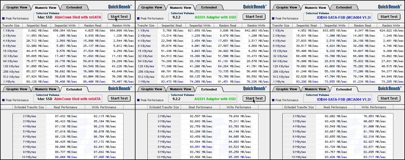

Run QuickBench on your Mini as it is and compare your results with these.
(Sorry, don’t have old conventional drive results handy.)
These results were from a G4 Mini running OS 9.2.2 with an mSATA sled and also with (2) different adapters with an SSD. See> http://macos9lives.com/smforum/index.php/topic,5955.msg44360.html#msg44360 for more in-depth info.
*Click on thumbnail image above for much clearer view.
